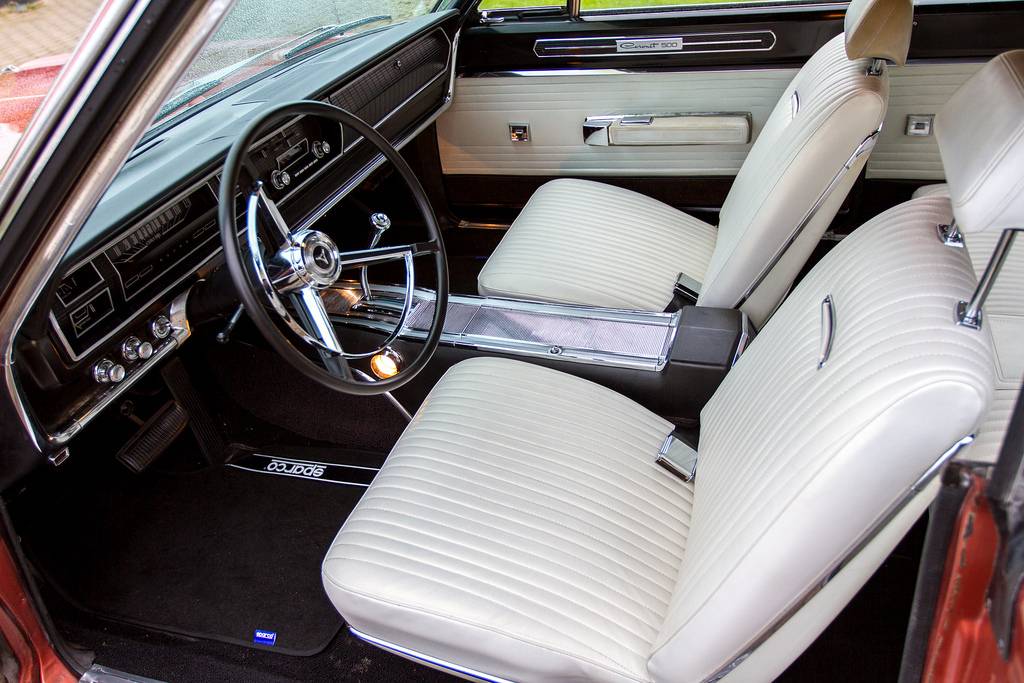

I don't know? I can't see any screw holes, or..I'm looking in the wrong place. I know mine is original to the car. I just thought the dash caps are so thin, they most likely are not bolted in. But, as I said, I am not really sure. I don't want to break anything, so I am asking first. Does anyone have experience with these?
My dash cap looks like this right now:

Guys the 67 coronet does not have a PAD, it only has a cap..At least in my terminlogy the only thing I can call what is there is a CAP. Under what I have now (see the pc above) is METAL. There is nothing 'soft' about any part of it.
I think from 68 onwards they got a softer 'pad' style dash upper. I might be wrong, but going from what I see on my car now (which is original) the replacement I have coming is exactly the same, same thickness, etc.

Yep, good. This is exactly what I want. My car never had a pad, and going on the looks of all of the pads I have seen listed for my year of make, NONE of them look like they will fit my 67 Coronet. I need my car to look exactly like it does now, just without the cracks in the dash cap. ;)

Your car has a dash pad in the picture. I bought the same one for my 67 Belvedere from here:
