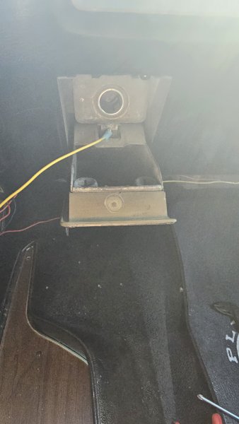

So, i bought the new instrument panel gauges and everything worked for 214 miles, then the speedometer quit working.

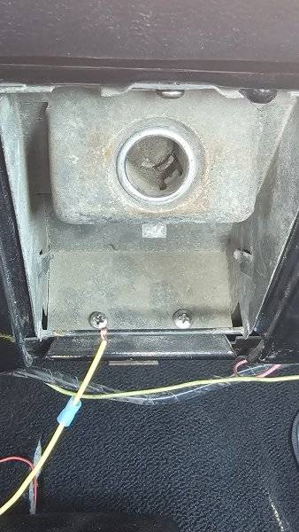

I really hate taking that dash apart but ok, I'll do it again. Tried a new ground still didn't work. So just as a curiosity while driving I was touching to what thought might be a good ground. What works is the tab in the ash tray! Wtf?
The original ground is connected right to the block! Why without the ash try work?? Not exactly where I want a permanent ground.
Any ideas what might be going on here?
These a Autometer gauges. Everything else works with its proper ground. I just find this speedometer to be weird, or possibly just me, idk??
Thanks!

The speedometer has power. It just isn't reading pulses unless connected to the ash tray.
This even works...

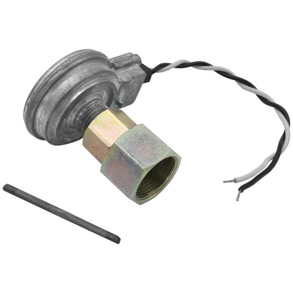

Is this a Hall Effect speedometer drive?
This is a 2 wire speedometer drive.
Purple reads pulses and yellow is ground.

I'm tempted to cut the ground wire and ground it someplace closer to the sensor. Like right to the transmission maybe??
You just need to connect the ground to the dash frame then. The ashtray is just attached to the dash frame.

This is the sensor I have. Wire color is just different.
