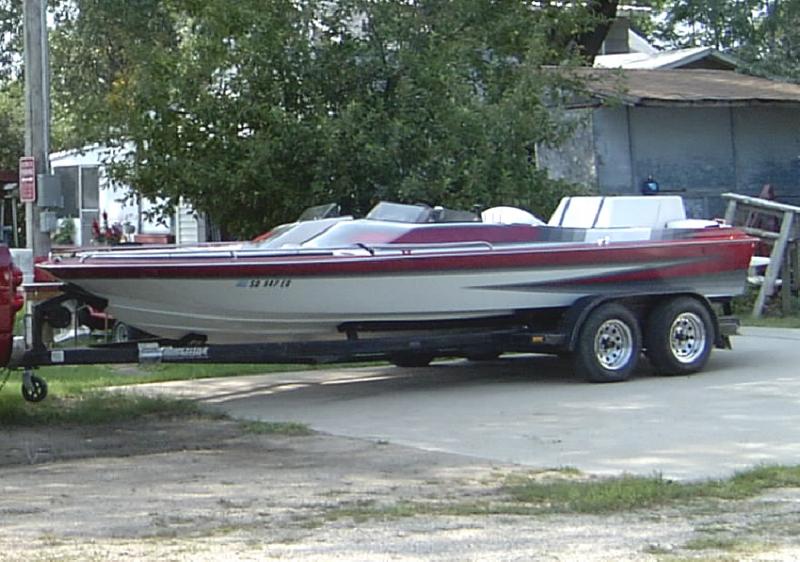

          Agree completely, especially about the SB Chevy comment. I am going to considerable trouble and expence putting a 360 in my boat after giving the original 350 (Mercruiser) a chance. The pistons were breaking edges off above the top ring land, with no signs of detonation... Simply just crap, as the thing on it's best day pulled 4600 RPM.
          The only advice here that I would wonder about, is setting the initial timing at 14 degrees advanced, as my experience with several Mopar distributors with varied replacement springs end up with total advance at 36-38 when the initial is at 8-10 degrees. I would assume elevation could play a part on this also, as I see ColoradoDave might have had some to deal with.
          I just finished a 440 earlier this year and around the 200 mile mark the temp slowly dropped about 5 degrees while cruising.

          nice boat!

          Good luck hopefully this will solve the problem! Very nice boat!!
