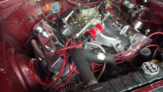

67 Coronet 440 with a 66 383wth 67 440 heads. Mopar performance cam. Edelbrach torker ll intake with a Holley 750
Nothing really special. Stock shortblock

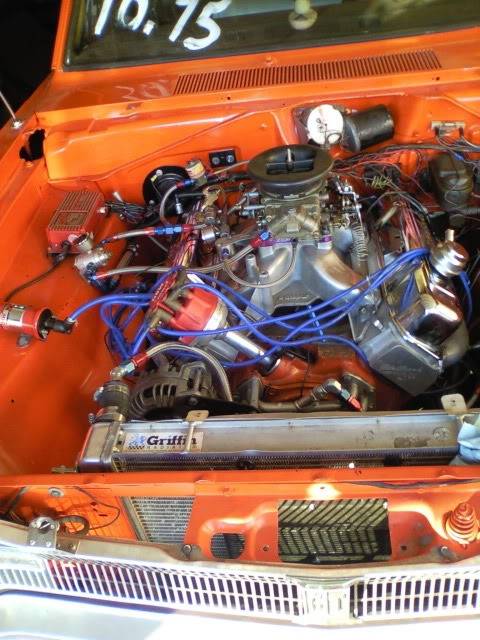

I run a 68 dart with a 400 based 499 engine.
I had the same thought which header would work best for my combo.
With the Hooker Super Comps.
9.62,9.64,9.64
Same day switched out to tti's,both are 2 inch headers.
Car ran 9.81,9.82,9.79.
I had the engine out of my 67 Dart street car that ran a best of 10.70 off the juice.
Both are open headers,both are the same day.

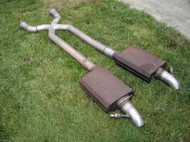

The H-pipe from tti on the 67 Dart had to go to a muffler shop to be installed because the driver's side collector was not welded correctly on and had to be adjusted and short pipe pointed slightly up towards the floorboards.
Another complaint about the tti's is why would they have a collector bolt so a bolt would be at the top so the bolt would be at the floorboard,look at the pic of the pipe's.
"...Another complaint about the tti's is why would they have a collector bolt so a bolt would be at the top so the bolt would be at the floorboard,look at the pic of the pipe's...."
Agreed, that bolt/ nut is a pain, but I believe it is done to give a cleaner finish to the bottom of a car...'visually' looks cleaner once assembled, and reduces a 'catch point' i.e.: moving a car on/ off a trailer. I know, "It's only a 1/2 inch". Sometimes that 1/2" can be a show stopper coming on or off the trailer!

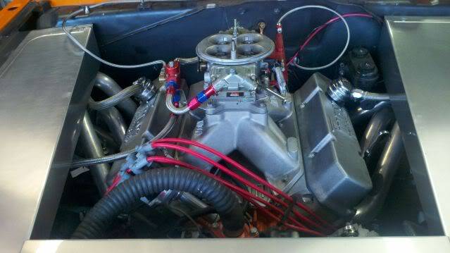

IMO as what i have just done to my 505 charger.
tti headers 1 7/8" 3" pipe x pipe dynomax ultraflo's loud and powerful.
for a mild 440 you can use the 2.5" pipe
On my 67 Charger I'm using 3 chamber Flowmasters.
No matter what engine it has in it, always sounds tough.
Currently it has a 512 ci. engine.
