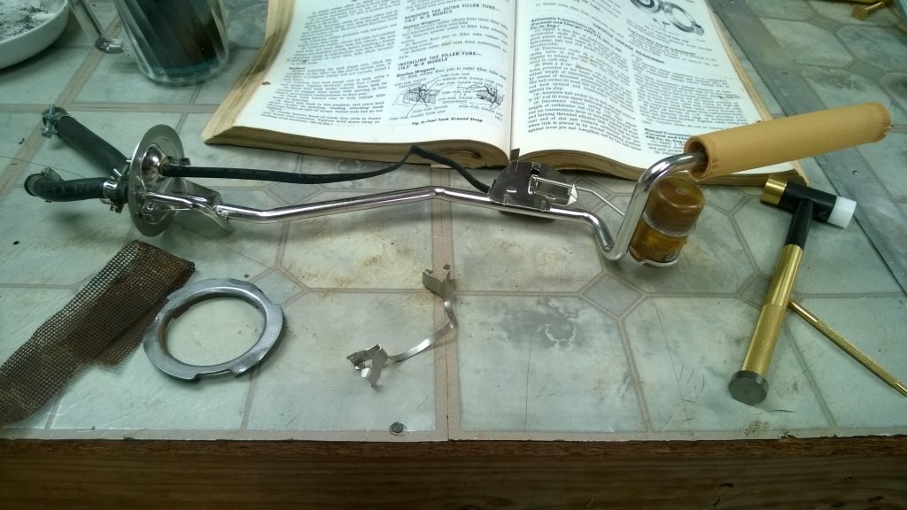

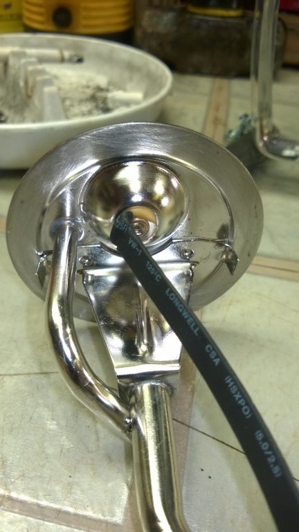

First things first - grab the brass drift and hammer (usually used when swapping my gun sights) so there's NO SPARKS!
Tap, tap, tap...
Well, that came apart rather easily. Everything doesn't look that bad, short of the gasket:
Ground strap intact, sending unit looks purty, locking ring shined up and checked true.

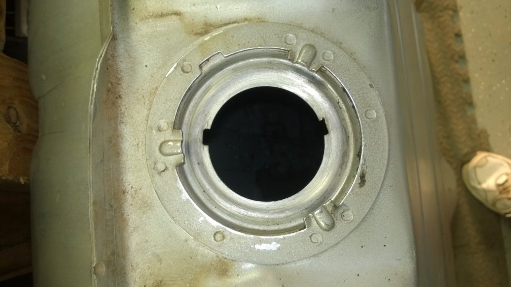

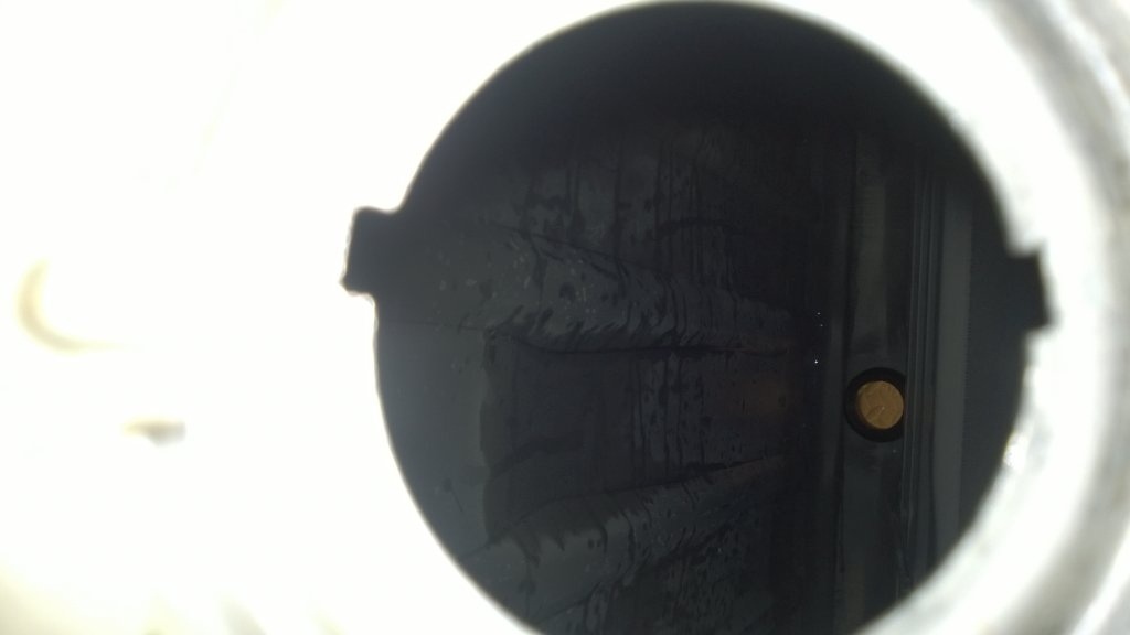

Inside of tank doesn't look terrible. I rinsed it out real well. I DON'T like this "zinc plated" crap, though. This is definitely a "ten year tank" from the looks of it.
Polished up the gasket surface of the sending unit using open-web emory cloth. This unit is definitely stainless, came out great.
Gasket mating surface of the tank, all cleaned up with emory. Looks fine to me.
RTV black looked fine and cleaned off perfectly; I didn't see any signs of swelling.
Any bending of the tabs that might occur will happen when I'm test-fitting everything with the new ring and washer when they get here.

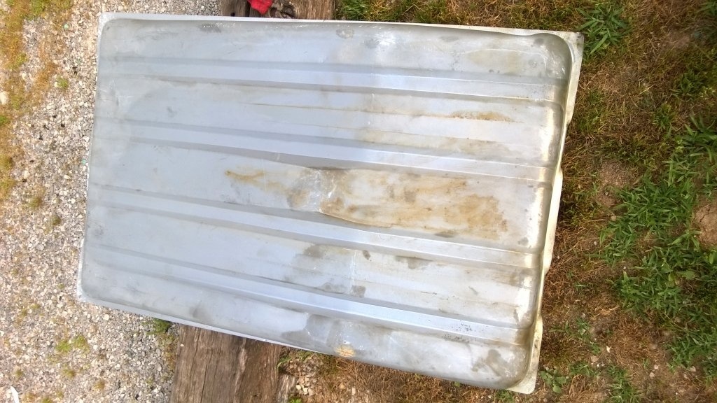

Wow, the bottom of the tank is looking pretty gnarly for it being a fairly new replacement - on a car that's only been driven a few hundred miles especially.
A lot of that is discoloration where the gas was running down it, but there's actually some surface corrosion happening already!
Again - DON'T BUY A "NATURAL STEEL" tank!

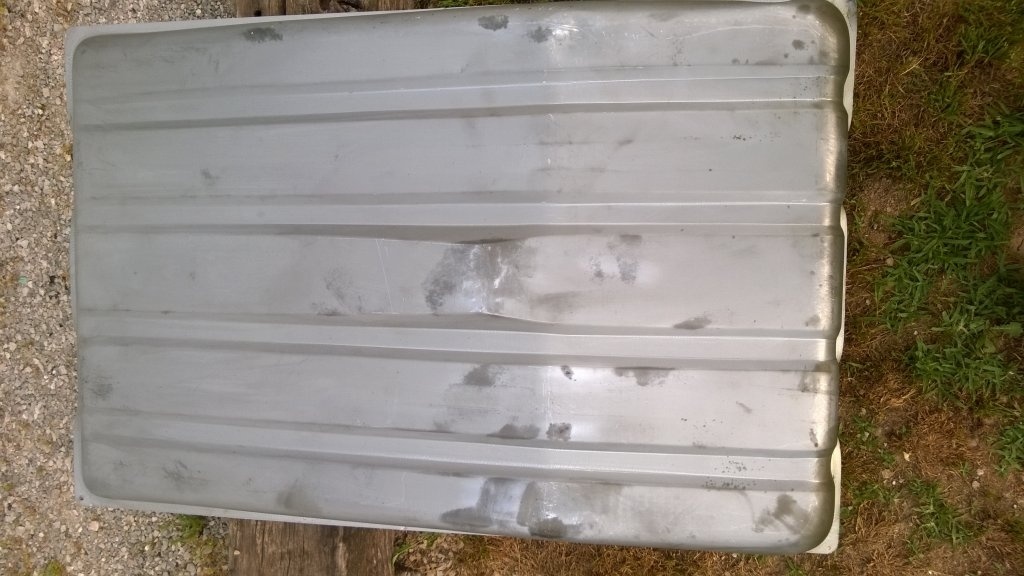

I'm taking Awesome! cleanser and some Nev'r Dull to this bad boy, trying not to use any scouring/scrubbing methods that'll scratch it worse (and give corrosion even more opportunity!).
Yes, Awesome! is the brand name; they sell it dirt cheap at most "dollar" type stores and Big Lots. This stuff will take the hide off a rhino, BUT - USE IN ONLY WELL VENTILATED AREAS!!
I can't stress that enough - the fumes from this stuff is ROUGH on your lungs. Don't get it in your eyes, either - but it is a fantastic cleaner for a bunch of uses. Use it like those purple cleaners.
Nev'r Dull has been around forever. It's a metal polish, typically used for polished brass and such. It's great at removing discoloration and corrosion and is very mild.
There we go, all cleaned up without resorting to scouring/scratching it up.
Notice the thing is losing its' zinc already?
Like I said, "ten year tank".

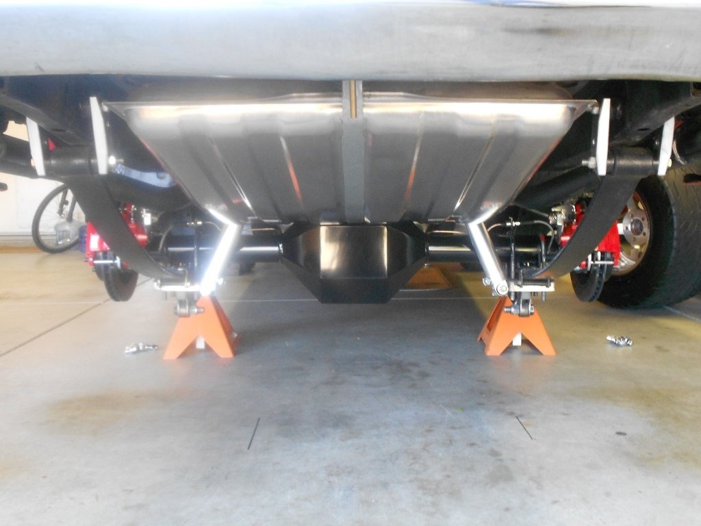

Look no further than the right panel on this page and call Laysons. They are a sponsor of the site and they have quality tanks. The sending units are imports but mine has been working well for a couple of years.
Look no further than the right panel on this page and call Laysons. They are a sponsor of the site and they have quality tanks. The sending units are imports but mine has been working well for a couple of years.View attachment 341027 View attachment 341028
Oh, I'm sure of it Dave - but Homey's budget is shot for now.
This one will do until greener (non-medical-bill) days arrive. :-)
Appreciate it, though. I'm well aware of Layson's. They do good stuff.
