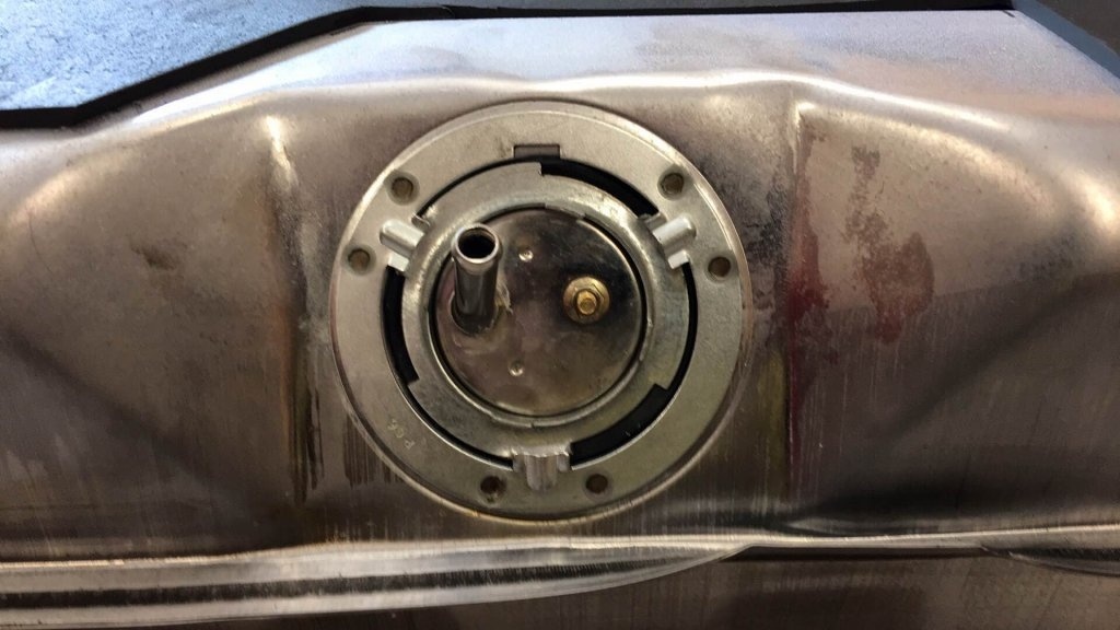

I recently removed a non-leaking sender to make an adjustment on the float arm. After re-installing the gasket it leaked with a full tank. Took a close look at how the ring was seated and it was actually the rubber gasket that had moved out of position. There is a narrow sealing ring on the tank, and while twisting the lock ring the gasket can move off-center.
After re-positioning the gasket and carefully seating the ring, the same gasket did not leak.

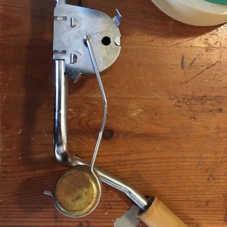

Also, here is the amount I bent the float arm in my 67 Coronet (previously it was straight). At 1/8 reading on the fuel gauge it took 13 gal to fill, meaning there was approx. 6 gal left. This calibration took 3 attempts including the familiar leaking gasket ordeal, so maybe this will help others.
Thanks for the info on the nitrile rubber. Used it yesterday when replacing my gas tank. Replaced sending unit couple months ago and it leaked badly. The locking ring and gasket provided with the sending unit was junk obviously. Got a NOS locking ring from "moparedtn"...thanks again man! And cut my own gasket from the nitrile rubber recommended by "69Runner"...thanks. Both those combinations ensured a snug fit and NO LEAKS.
