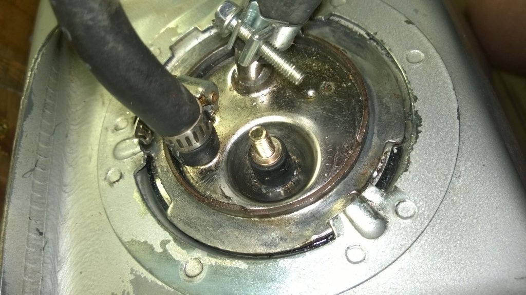

@^%$ new gas tank STILL leaks!
I put a thin smear of Permatex copper ('cause that's what I had that hadn't gone bad) on the ridge on the tank that seals the gasket and on the back side of the sending unit. I'm letting it set for a couple of days before rolling the dice and going to the gas station.
Should be ok. I think Copper is fuel resistant, right?
Most silicones are not recommended for gasoline, but everyone uses them on intakes. Look for Permatex #85420, it is a urethane based sealant, advertised as fuel resistant. Orange tube but it is actually blue, similar to Hylomar.
Very good sir, thanks.
Note: The "RTV Black" I used before also says it's gas-resistant and like I posted before, I saw no evidence of it failing.
I'm still debating using any sealant at all this time. Darn gasket should work without any.

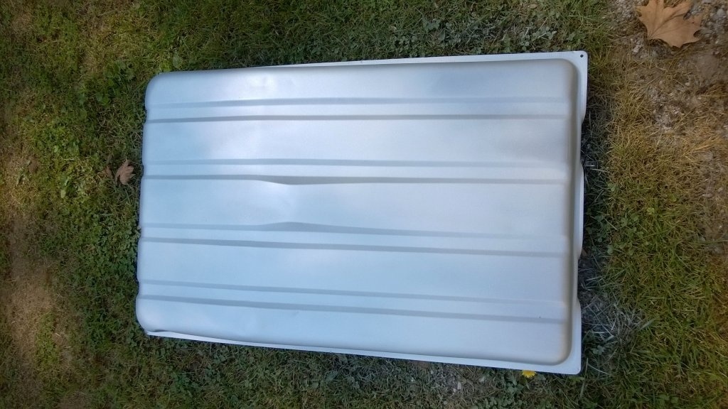

It appears, least to me, that what's left over on this thing is actually the zinc coating being uneven or even going away in places. I got the stains off the tank; what's left is basically darker/lighter patches of that coating .

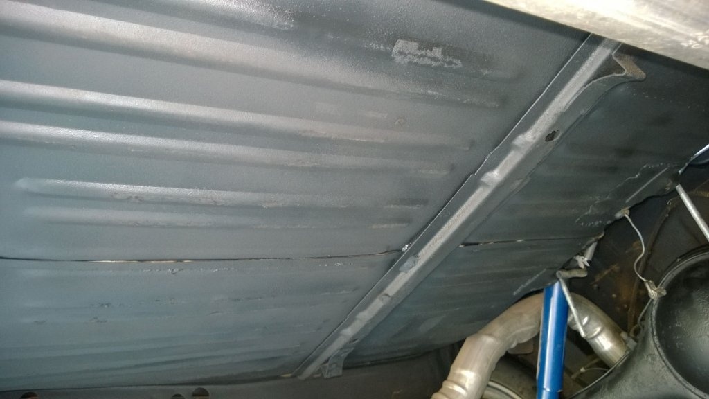

Also took the opportunity to touch up some of the previous owners' attempts at painting the underside of the replacement metal in the trunk.

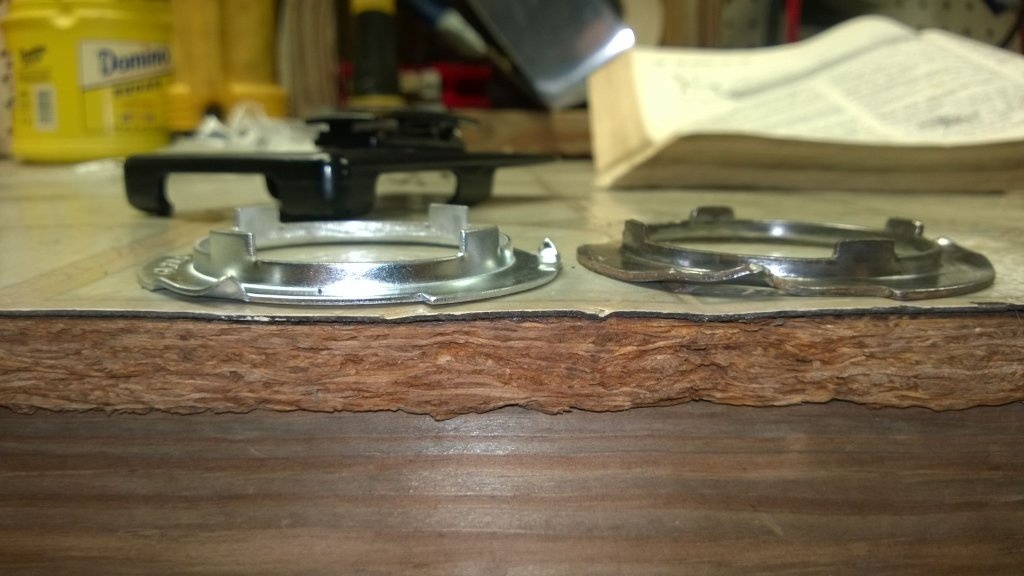

I got the new gasket and locking Ring I ordered from NAPA (Spectra #LO06 for those playing at home). I only wanted a gasket, but for $4, I ain't complaining.
What I have NOT received yet is the new MOPAR locking ring from MoparMitch. :(
Well, time's up. I wanted to do this on the weekend and I'm not one for patience (you die a few times like I have and you get that way). It should have been here by now.
No worries, I still have my original equipment one. I cleaned it up with a wire wheel on my Dremel and off we go...
Look at the difference in thickness between the new Spectra on the left and the original on the right. The original feels twice as heavy and has more "meat" in the ramp areas that slide up under the locking tangs on the tank.
Sorry, Spectra, you lose.

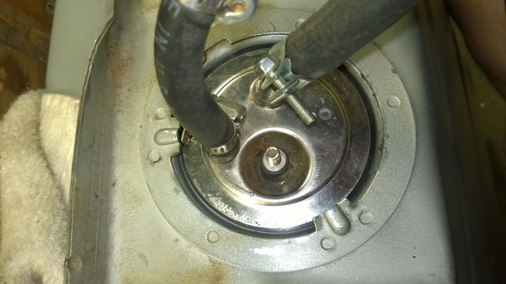

New gasket looks good and has a little overlap all around. I centered up the sending unit and had a look. Looks real good. Ok, locking ring time (I decided on no sealant).
Original locking ring fit really snugly and it took some time to drive all 3 locking nubs on it into place in the tangs of the tank. The fit felt really tight and I was unable to move the sending unit at all once installed.
I used the same brass punch as before and there were literally dozens of taptaptaps involved to get the locking ring fully seated, so I'm very satisfied with the fit.
BTW, notice how the zinc is flaking off the tank already?
Yeah, like I said, y'all don't buy any tank that's described as "natural steel with zinc". Just don't.
I gave it a quick shot of clear to try and seal the surface.
There's a tool for that, maybe the hammering is damaging the locking tabs?
