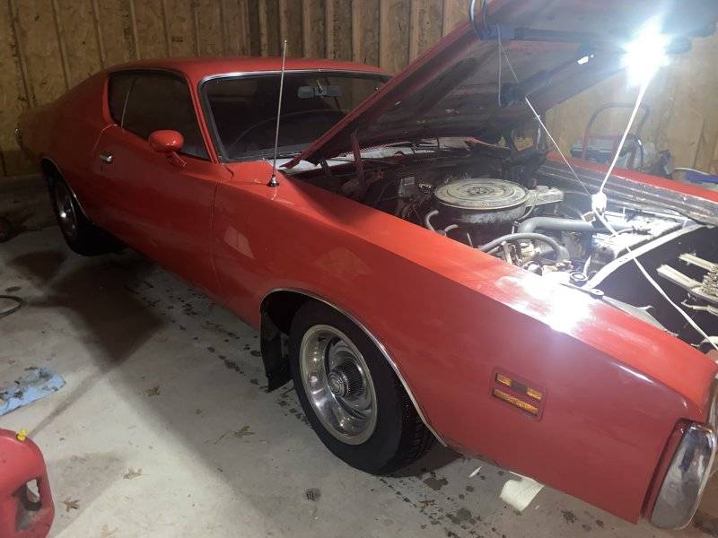

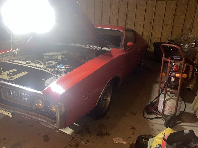

Thanks for all the welcomes. I don’t have a lot of time to work on it and it’s not at my house yet so I’m dragging tools & parts back a forth but it’s close to being ready for the drive.
Drained the tank and added fresh gas and it’s coming out clean so far. May not have to replace it. Replaced a blown exhaust manifold gasket that sounded like a valve tick. Set the swell/timing, going to need cap/rotor/wires/plugs. Cleaned out the carb but it needs a accel pump/kit.
Fires right up and idles smooth and so quiet I can’t tell it’s running from inside the car. Drove it up and down the street a few times in a heavy downpour and it did ok but stumbles because of the carb. Heater & defrost still work but blew acorns all over the floor. Shoes are good but drums need turned and brakes bled.
There is very little light in the garage it’s in so the pics aren’t great. It’s like working in a cave. Hope to get it home shortly.
