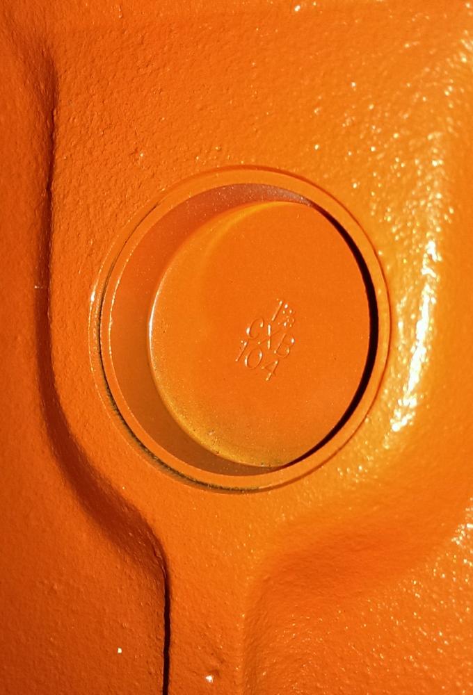

Here is the offending plug holes lol, notice the old rtv left behind? and a pic of the one in the back next to it for refference. Looks like I will be able to change it, but don't tell my wife as I am using this as an excuse to get me them tti's lol
Anyone see any thing out of the ordinary? Asking not saying.
Mums the word!
JMHO, I don't like RTV. It doesn't stick to anything. Paint won't stick to it so I'm not going to use it.
It might just be the picture but those plugs don't look that tall. I know they make all different height plugs. The taller they are the more side wall you have for more surface grip. Not saying that shallow ones wouldn't work ok. Here is a pic of the ones in the engine that I have. The plugs are almost a half inch tall. Installed without any sealer. If the holes are pitted, I like useing Permatex #2. Are we having fun yet!

Yup, lessen learned. Neighbor has the install tool to lend so should be ok. Will know this weekend after fix. hoping noting else is wrong.
