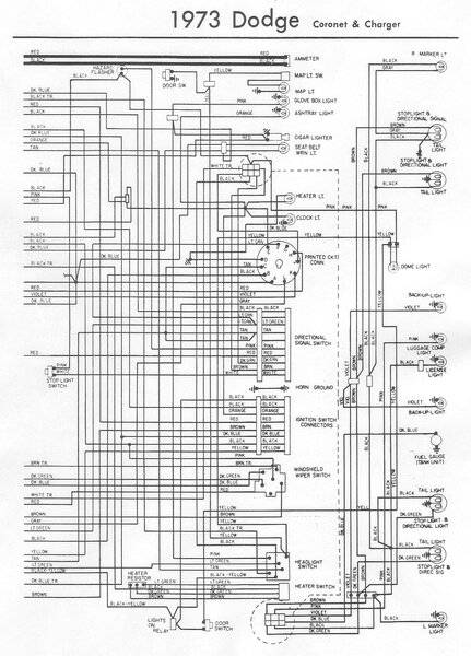

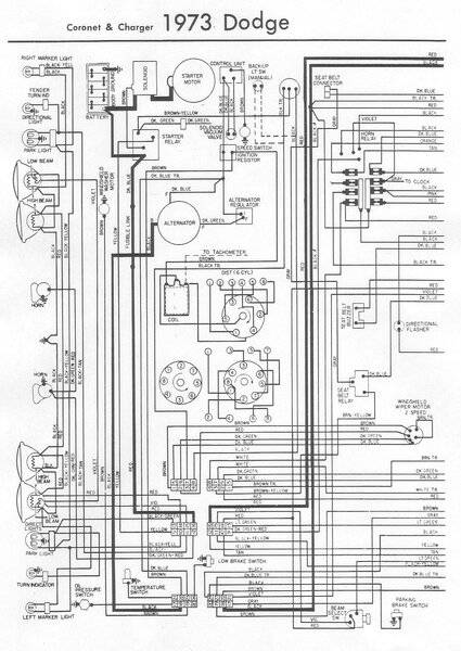

Hi im new as a poster but ive been reading this forum since i got my charger. I have a 1973 dodge charger with a 400 in it and i just removed the engine for a mild rebuild but while its out i want to do a new wiring harness but i want to make it myself (i know im crazy). The old harness is deteriorated and the fuse block is a lvl 10 fire hazard so why not go custom? i was curious if someone has made or knows someone that has made a custom/more modern harness and if they have a diagram/tips/hints that could help me. Thank you in advance!!

Welcome from North Carolina. These wiring diagrams should help you out. Take your time and have patience and you should be fine. Good luck.
http://www.mymopar.com/downloads/1973/73CoronetChargerA.JPG
http://www.mymopar.com/downloads/1973/73CoronetChargerB.JPG
