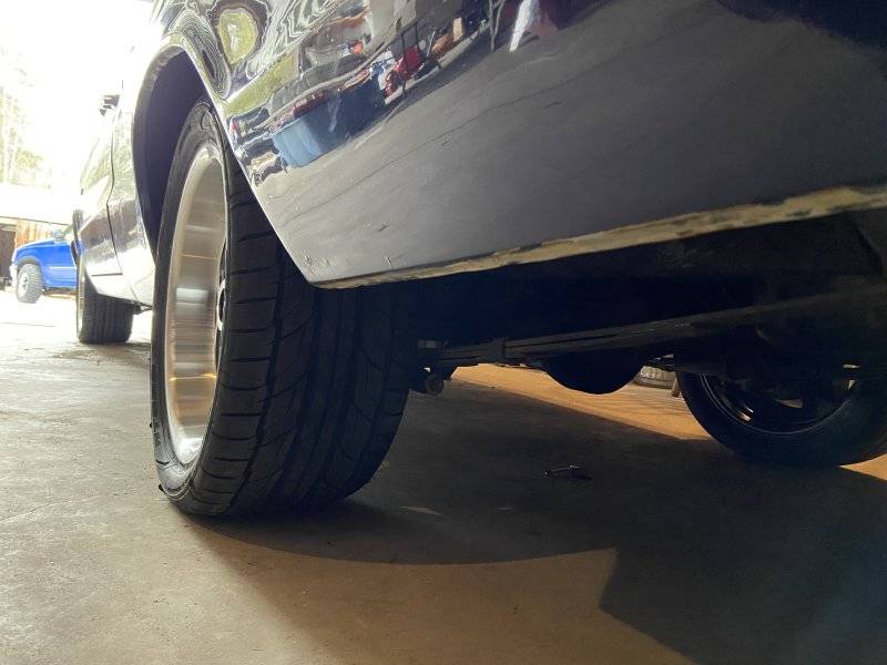

245/40/18 front nitto g2’s
275/40/18 rears nitto g2’s
Next time I will go with a 295, just gives me a reason to burn them off quicker
