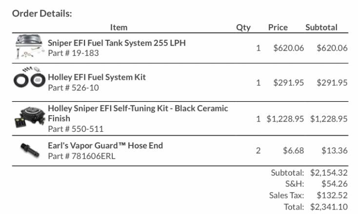

What fuel delivery system are you going to use for the Sniper? That should be lots of fun to drive.

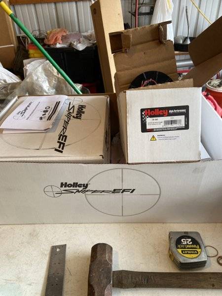

Uhhh...In this picture I see a lot of things including the Sniper EFI kit and a hammer.
I hope for your sake the conversion doesn't make you so mad that you smash things with the sledge hammer.
Holley told me there sending unit with pump would work and all I would have to do is drill a 3&3/4 hole but there is no spot to do it so now I have to call them so I can send the sending unit n pump back and they can send me there tank with pump and sending unit and float
