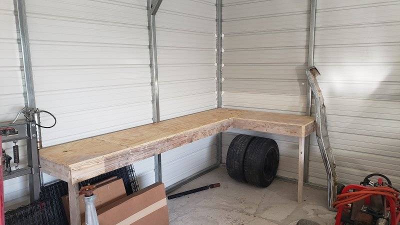

Once I put in shelving it will be better. No where to put things except the perimeter for now. My wife wants a pulley system to store her kayak above the bay so she can just lower it down and go.Isn't it amazing how fast all of the space disappears once its occupied?

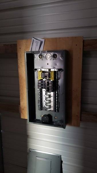

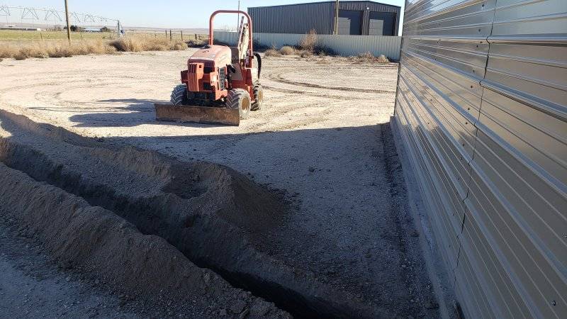

Trencher is about $280/day. Need to trench 60'. As far as wiring it, easy peasy. I can order the wire and hard parts as I know what I need. But do I really want to do it? I would have bit on $1500-$1700 to do it and be done. Cable, trencher, conduit, 100a panel, plus breaker would run me about $850Know how to run an excavator or trencher? If so what does it cost for half a day? See if they'll knock some off and how much, if you do some of that grunt work. Maybe see if you can be their helper on the inside running wire etc. See if they'll give you a shopping list so you can supply the parts, wire etc. and they just bill you for the labor. We did that here on several areas of the garage. Another is to offer to pay in cash. Cash discount?

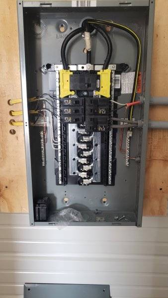

Direct bury is 24". Both ends need conduit 18" in the ground up to the building entry. The trencher I have rented is 30" max so I'll go to max. I'm running 1/0-1/0-1/0-2 Al which is good for 130a, 80% nec ruleNavada, i paid for 3- 4AWT an 1 number 6, 375’ 6000$ contractors price And the contractors price was through electrical outfit way cheaper then Home Depot and all was copper.
I also had electricians that didn’t show after doing half the job. Finally got a guy that was way cheaper and smarter then the rest. I bought a tractor trenched the last 30’ myself plus will use it for Other things.We rented a tugger and had the use the tractor throughout the couple christy boxes i had. Good Luck
U need 18” plus the 4’ depth correct?
That’s something i will be doing so i can add cameras.Add a 1 inch conduit in the trench with a pull string for future cat 5 cable for internet or security system.
