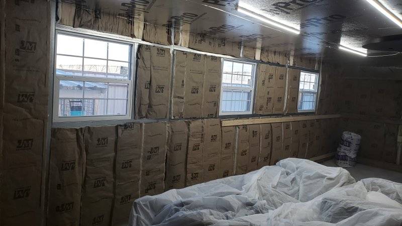

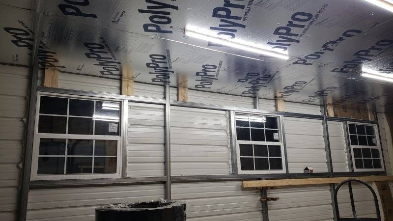

I’m curious, how did you attach the ledger board of the ‘deck’ to the outside wall of the building? I’m looking at the picture on a phone so maybe it’s more obvious on a computer screen. Did you just lag it to the upright structure beams or is there more blocking behind that?
Lag bolt right to the uprights. They are 5' on center. 3 bolts in each. Plus, on the window side where the ledger is bolted in there are horizontal members so I bolted up legs from the ledger. So it is bolted to the steel and sitting on the steel, if that makes sense.
