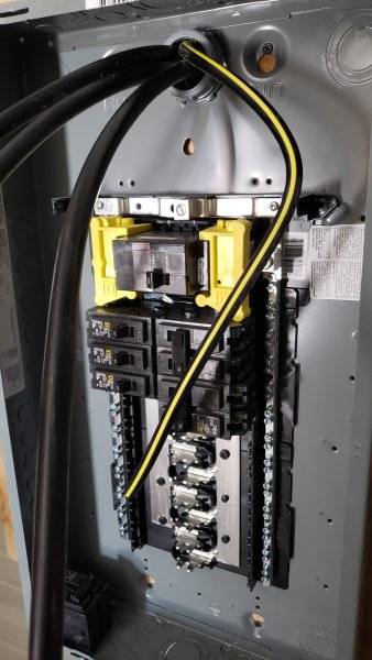

Installed a 25,600 btu/hr 240v garage heater I found on sale after Thanksgiving. Direct wired in. I'm still waiting on an insulation company for a spray foam quote.

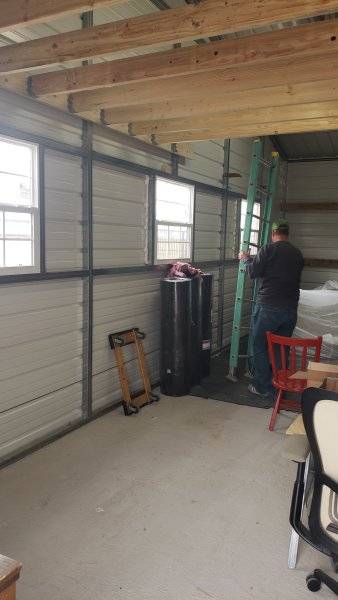

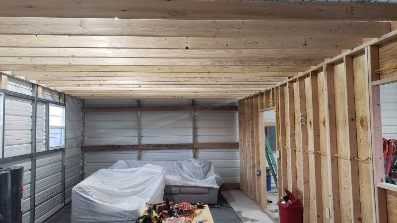

Got the rafters set today. 16" on center. Got one facia board nailed in then I called it quits. 7/16 osb is going on top, maybe tomorrow.
That space is 14 foot wide. Where the couch is setting will be my wife's workout equipment. She has a 14x20 foot chunk for her stuff. Couch is going by the door and a TV and beer fridge going next to it.

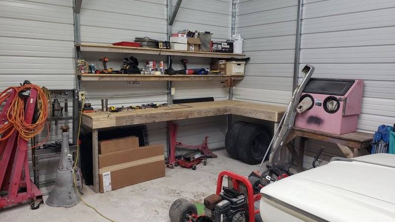

For sure latch onto more shelving. One thing I've done for much of my stuff is put them on wheels. Having the equipment, tools, bolt bin etc on wheels makes it nice.

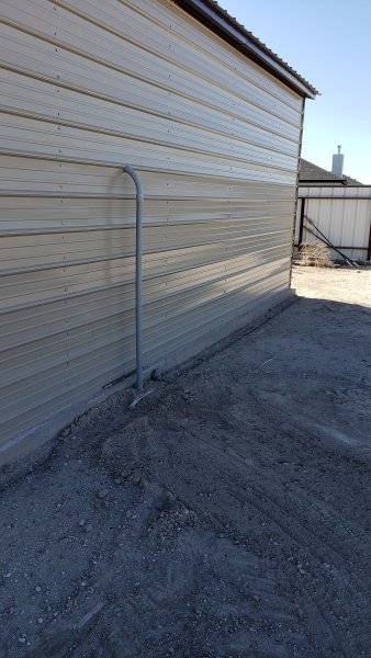

Line is buried! I went about 30" so any dirt that fell back in the trench wouldn't be an issue. The original walk behind trencher wouldn't start. So they offered a Ditch With RT-45 at the same price, plus they drop off and pick up...about $300 for the weekend.
On the shop side, it is encased in 1 1/2" pvc down 18" and right into the box. I also used the machine to scrape some brush up around the property.
