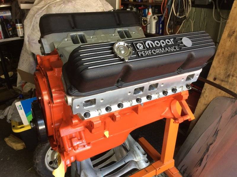

What should I do? Buy a set of Stealth Heads or use the 452 heads?
I have a 78’ 440 block, cast crank, stock rods, engine guy says will be approx 9.4:1 with new pistons installed using the 88cc 452 heads. Going in 69’ roadrunner, prly use 78 tranny (someone suggested it might have part throttle kickdown), 3:23 suregrip.
I don’t know what to do. Not a strip car, just interested in a strong cruiser. Like to put some miles on it.
"engine guy says will be approx 9.4:1 with new pistons installed using the 88cc 452 heads"
ANY Engine Guy that can tell you the above..... should also be able to make a cylinder head recommendation based on what you want.
and IMO,
complete WASTE OF TIME and MONEY even considering "rebuilding" 452 Irons Vrs buying STEALTH Heads, very simply because you can NOT rebuild irons(any iron head) properly..... or that even with Porting...... will even come close to the performance potential of the STEALTH's out of the box !
Add in the reduced Fuel/Quench/Detonation and thermal efficiencies of the Aluminum vrs the Irons and this should be a NO-Brainer !
BTW, WHAT Pistons is your engine guy using to achieve the 9.4:1 ?
