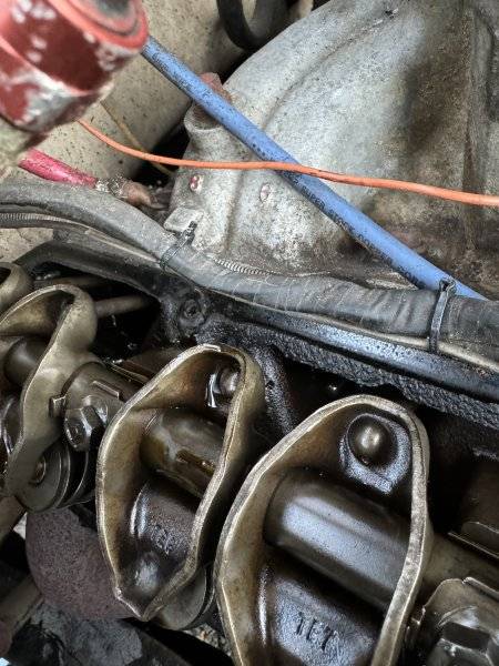

the engine runs good just a little funny sounding at idle and old timer said he can hear that the valves need adjusting….he also told me the truck has aluminum rockers
Yes but the problem should be properly diagnosed before ripping any parts off just yet
I agree, but those compression readings have valve train issues written all over them, or possibly a timing chain issue. The engine could need a total rebuild, but I don't see finding out without taking something apart to look. Start with the valve covers and go from there.
Hmm.. that says alot. Yes time to lift her skirt
Now you have told us a little more. Yes a valve adjustment could be the problem, or even some bent pushrods. Burnt valves? You will be able to tell more when you get the valve covers off. If unsure post pictures.
Missing a pushrod!!!

Sounds like the old-timer was right about the ticking!!
Just wrong about the aluminum roller rockers.
