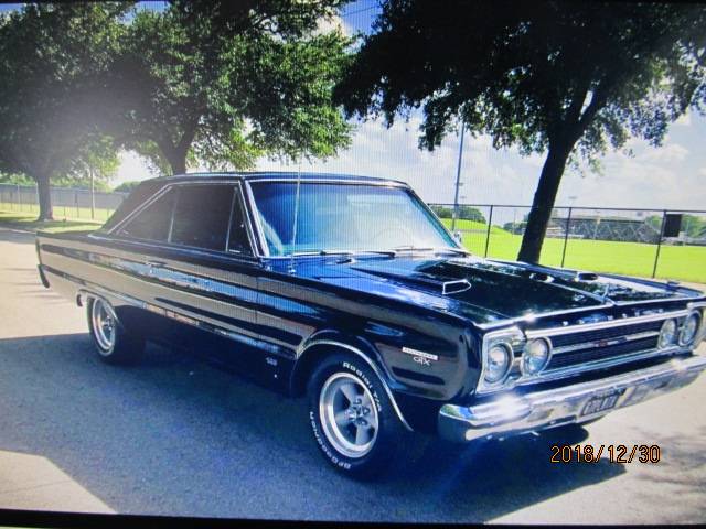

hey guys,
newbe here,i have a 67 gtx tribute with a crate 512 stroker, rotisere restored.i have a problem.my oil presure runs at about 50-75 on the highway,but when its hot it idles about5-10.im using 5/30 synthetic.do you think if i went to 10/30 it would help or should i go ahead and change the oil pump. thanks.

Welcome aboard from NJ. Beautiful car and thanks for posting the picture without us having to ask!
