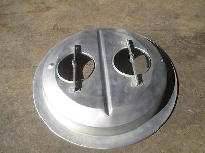

I would still like to see where the tube connects to the air cleaner. As I mentioned my 69 coronet air cleaner has no place for the tube.
There's a port on the rear of the base plate where the rubber hose attaches, as seen in this photo to the right....

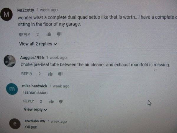

Was looking through the list of responses and found this. I don't know what a week ago means.:)

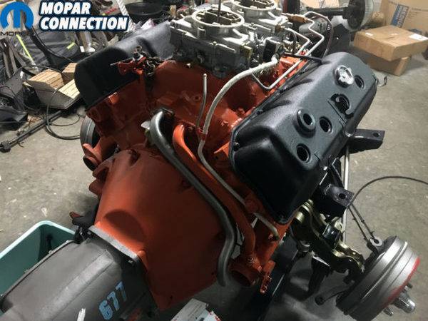

I disagree. Only one choke heat tube is on that engine in the video.
Found another pic with both choke heat tubes. View attachment 545538
I see what your talking about. The choke tube to transfer heat to the choke mechanism, the insulated one, is there. That's called a choke tube.
The other tube that RC pointed out isn't on Nick's engine. The one that goes to the air cleaner. My question, what year or years did they use that tube? Nick stated a couple of times that he is going by 1969 to 1970. He also said he is useing 1969 carburetors. He flips back and forth between the two years for the application that he might be using on an E body car.
Looks like from '66 on up. Might be it, if he doesn't come up with an excuse why he's not useing it. Like the different valve cover breather with one nipple instead of multiple. Or the 70 carburator vent tubes he's not useing because he's useing '69 carbs instead without vents. Time will tell.
66-70 Hemis used the "automatic" heated choke. In 71, they went to a manual choke.
