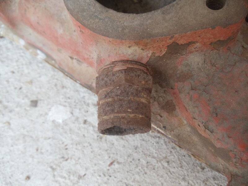

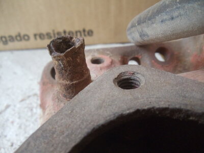

Thanks for the nipple tool ideas, I will have to try them out on a factory cast iron 340 intake I have on hand. My previous nipple tool (see first foto) was not effective at all.
