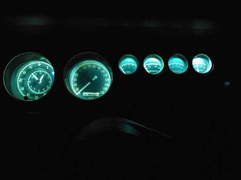

You could send your panel dimmer to Devinism. (Devin Duke in California) He will rebuild it better than NOS. I sent him two for rebuild and have an extra if you need it. As for the bulbs, you can get led's that will out last those conventional bulbs by many years and are much brighter. I bought some blue ones on Ebay that work well. They are fussy as to continuity though. If they won't light up, you need to turn them 180 and reinstall them. A good time to do that is on the bench where yours is now.

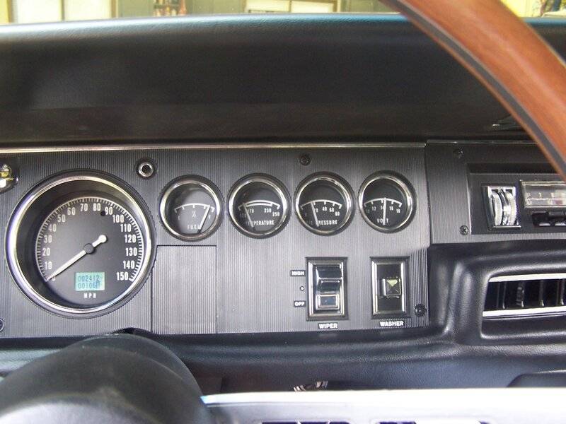

Like you said, you don't want to take it apart again so you need to do it right now that you have it out. It would be a good time to calibrate your gauges too. If you have a good fuel sender or a 0-100 ohm rheostat you can test and adjust your oil, fuel and temp gauges. (10 ohms=full and 75 ohms=empty) Those ohm readings are the same for temp and oil pressure gauge also. Also a good time to ditch the amp gauge and replace it with a volt meter. 50 year old ammeters are good for creating meltdowns. I sent my gauge panel to Redline Gauges for rebuild and had them replace the ammeter with a volt meter. Spendy but not near as much as a fire. Here is a pic of mine after the resto.
