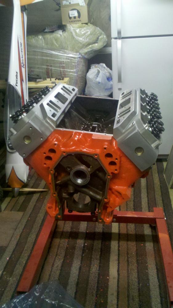

So I built a big fancy fast engine. Edelbrock Performer RPM heads and Intake, Harland Sharp Roller Rockers, .513/.533 @ 289° Lunati Cam, Windage Tray, High volume oil pump from Mopar Performance, Edelbrock Fuel Pump, Edelbrock Performer 750 cfm, MSD Ready-to-Run and MSD Blaster 2 coil, Hooker Headers. Vroom vroom.

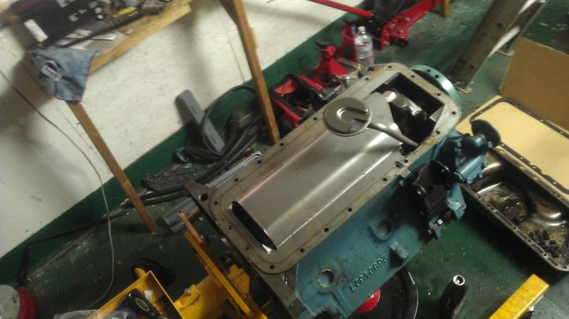

A galley plug! That's a good one. I'm very suspicious of the oil not getting to the pan, and the dry stick. As per the photo of the windage tray you can see there's a special tap in the tray for the dipstick I don't see how the stick could wind up on top of the tray (I was sort of suspecting the same thing which is why I went and dug up the photo from the build). But the tap goes through the block and through the tray, right behind the pickup on the port side as you can see in the photo.

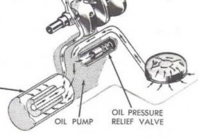

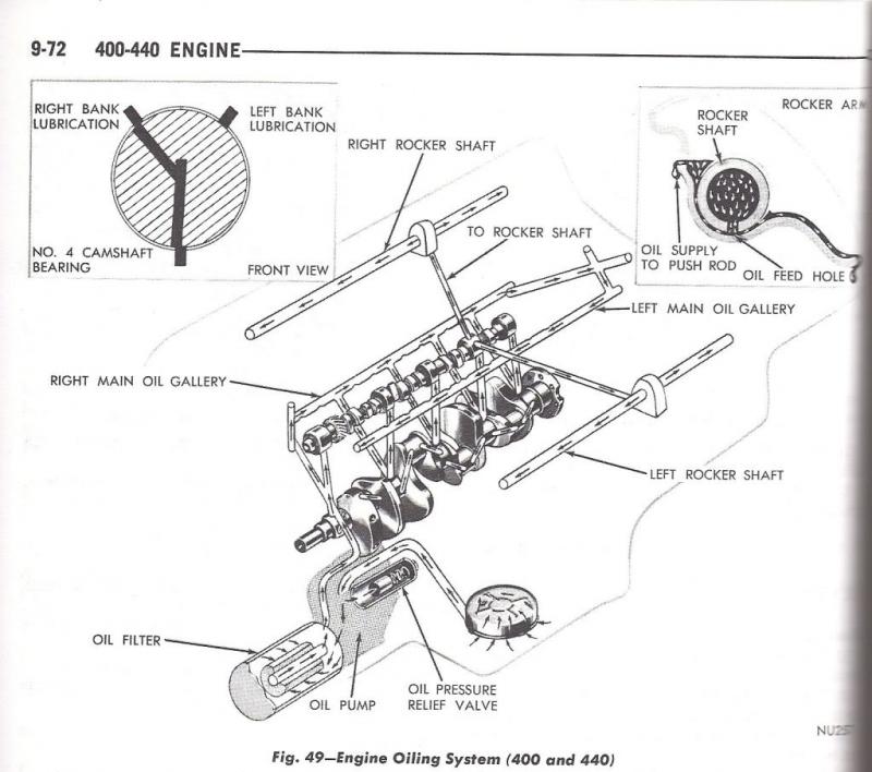

There could only be one oil gallery plug missing to cause your symptoms, and I doubt that's your trouble.... The one that "Could" be missing causing low pressure and not noticeable "oil all over the floor", would be the one behind the timing cover "right main oil gallery".....
Try using the prime shaft on a drill to check for oil pressure "With a mechanical gauge". If you have nothing using this method, pull the plunger and spring out of the oil pump, clean and inspect.... This "spring tension" is what sets the pressure of any mechanical oil pump. The pressure pushes the piston with the tension of the spring regulating how much effort it takes, thus changing the system pressure.

67 B-body has a good point ! Also the drawing is GREAT info on the system. And I had a pressure spring go bad in another brand before. Oh and if I may ask you 67 B-body ? What heads are those ? And how you like them. You can PM me if you like as I am starting to put a parts list together for my buld.

The more I think about it the more I think there are 2 problems and 2 different causes.
1) dipstick reading no oil
I agree, it probably isn't a galley plug, because their would be little pressure, but plenty of oil in the pan. Sounds like the wrong dipstick or just not enough oil. Stock pan is 4 quarts plus 1 in the filter, so maybe 4 qts just doesn't register after you fill the filter (I never bothered to look until I get 5 in there). Mine registers toward the top of the full line with 5.5 qts or so.
You either don't have enough oil, or you have the wrong dip stick or it's installed incorrectly. Maybe the tube isn't inserted fully? This would cause the dipstick to read shallow.
2) no pressure:
If there is no flow, the problem has to be in this picture. Remember that the oil pressure switch is out back, so if there is a clog in the main galley right off the pump, the pump is seeing pressure but the sender isn't. If the problem were a plugged rocker shaft, the oil would just go elsewhere and all would appear ok until you heard clatter in that bank. Could also be the pickup is not functioning or is not seated properly. Or maybe you have a plugged filter?? But either way, if this were your only problem, you would see oil in the pan.
