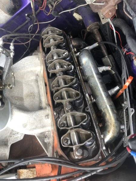

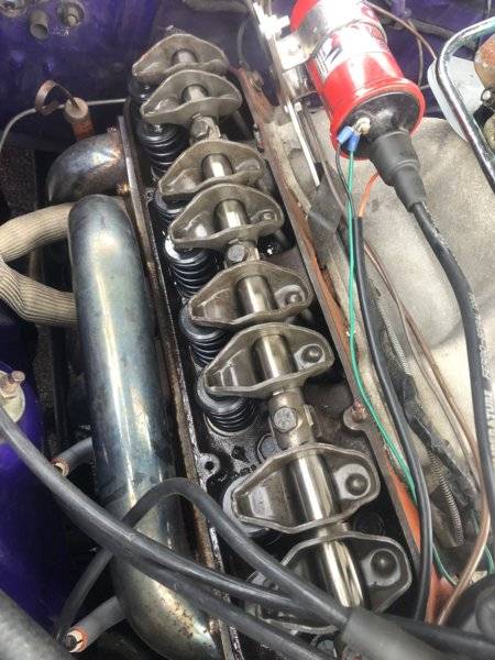

Recently picked up a car that had been dormant for alitte over a year. Engine is 440. Was said to have been a strong runner.
I started the process of waking her up. After replacing the oil, filter and priming the engine, I had good oil pressure but noticed nothing coming through passenger rockers. Any of them. I thought maybe upon cranking or start up once the holes lined up it would come through. I fired her up and after waiting a few seconds and oil rushed through the drivers side and nothing through passenger. Decided to shut the motor down.
What would y’all opinions towards my next course of action or things I should check?
I have not adjusted or had the rocker arms off but I cannot speak for the previous owner. Does look like the heads were gone through In the somewhat recent past.

You could take off the whole rocker assembly on that side and run a wire down the oil passage to the cam. Pull it out and see what it looks like. Maybe gunk in the passage clogging things up.
Worse case scenario, cam bearing has spun or moved.

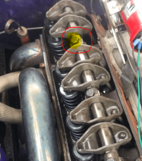

You will have tension or pressure on some of the rockers when you loosen the bolts. Turn the bolts evenly as you loosen them.

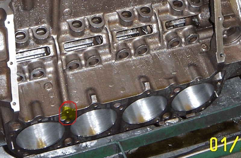

Good advice on what Daves69 said about just pulling the one bolt. That's where the oil passage is. I had assembly lube clogging my one side before I started it for the first time.

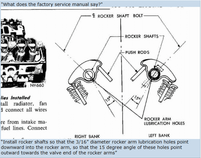

Also take notice as to where the oiling holes are pointing. Should be pointed down and toward the valves. Take pictures if you can.

IF all is assembled correctly, your problem maybe you didn't run engine long enough to prime the passenger side rocker gallery. The oil supply to the rockers is not full time, but for a small phase of cam rotational position. Pull dizzy and prime again whilst either bumping starter or turning engine by hand in small increments at least 2 full revolutions (= 1 cam revolution). You will then know if you have oil supply to both rocker shafts.
If you look in the manual, under rocker arms/shaft, note that the oil feed hole to the rocker shaft, is slightly offset to one side.
Those shafts work on either side, but the oiling holes in the shaft MUST be located right, by the manual. If the shaft is installed 'backwards', the offset feed hole isn't located right, and is partly blocked. It would be worth pulling that shaft, and make sure it's installed right.
Stock rocker oiling is not direct...meaning, the #4 cam bearing feeds one shaft, then the opposite, as the engine rotates. So, yeah, some rotation might be needed, if everything is installed right.
On the safe side, with that rocker shaft off, you could pre-oil, to see if your getting oil through the oil port from that side. If not, you need to find out why not.
Be sure the rocker shaft itself is clear, on the inside, while your at it. All pretty simple, and effective, if things are lined up.

Understand the parts and pieces off the rocker shafts, are under ALOT of pressure. So, it must be done right. Simply because the engine is together. Slowly, evenly, break each rocker shaft bolt loose...only loose. You need to keep every separate part, rocker arms, push rods...in their original location!! You can slip a wire rod under all the push rods, if needed to help.
Then, slowly, evenly, back out each bolt, until their free. You will be relieving pressure off valve springs, at the same time. Keep all the parts on the shaft in place. You'll go back on the same way...unless the shaft is backwards.
Pull the shaft, and take note where the oil feed holes are. There's two, only since the shafts can be mounted on either head. Decide if the holes are in the correct position. If not, lay the shaft on the bench, slip it off all the parts, flip it, and re-mount all the parts in the same order. Go by the book! That simple little mistake is done all the time.
Once things are right, put the shaft back in place, and run the bolts down, by hand.
Once it's time to bottom, and tighten the bolts, it must be done evenly, the length of the shaft. Do NOT force anything, but allow the parts to settle into place, as you go along. Take your time, and you won't have any problems.
