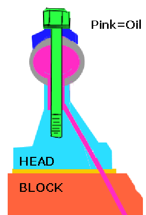

The oil port in the block is a lot smaller than the bolt hole. You need a small diameter wire that you won't break off and become a restriction.
The small hole in the block you are trying to hit is the top one. The corresponding hole in the head intersects the rocker shaft bolt hole. The hole in the rocker shaft is opened up for oil to pass through......

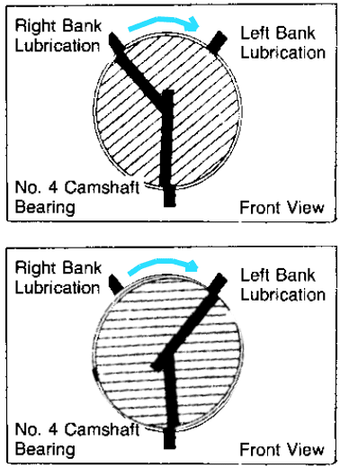

If the cam bearing is spinning with the cam, would it not still oil both sides?
