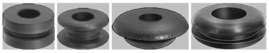

Thanks I am going to get one as soon as possible.Any time you have a hole through metal, a rubber grommet should be inserted to keep the wire from rubbing on steel. Pick what works best.

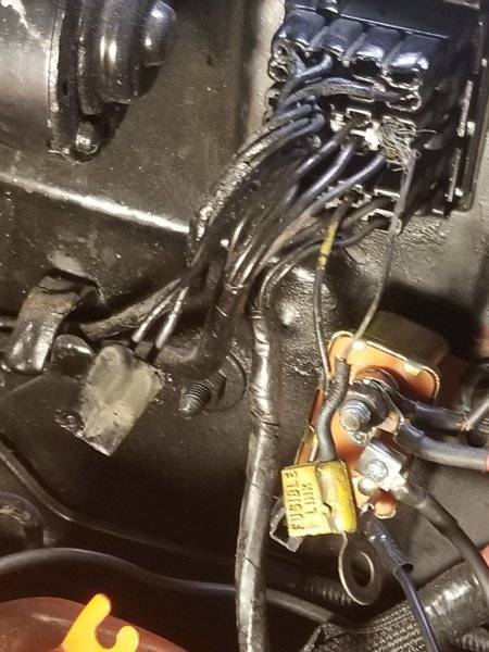

in your picture in the upper left corner i see what looks like a wire connector eyelet, what is that?. the insulator he is talking about would be a round rubber shield so that the body does not cut in to the wire. that wire should have ran through the bulk head connector i believe.
Electrical on these older cars are pretty simple, your missing main power or ground. What is that other eyelet that i seen in your picture?OK, I am very week in the electrical area but I will try. The ground is tight. I think the other stuff is good. I couldn't figure out how to test it with a meter though. What I am wondering is why I don't even have lights?

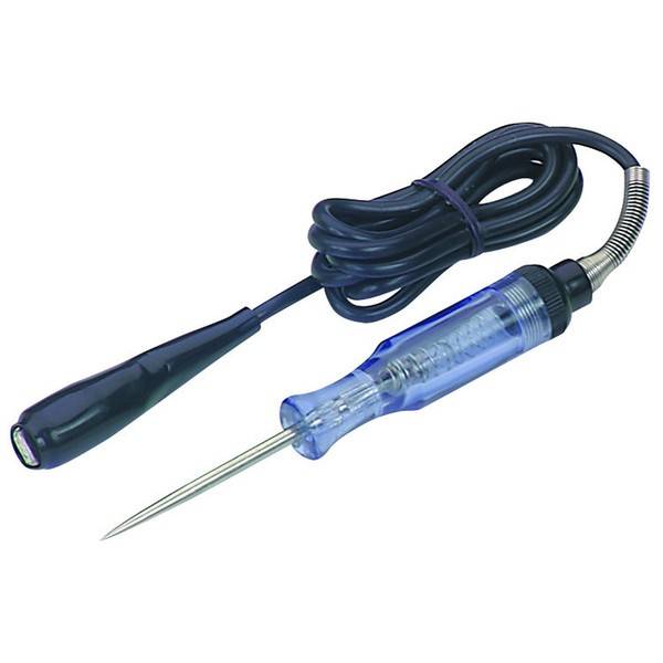

do you have a test light?they are cheap and easy to use.View attachment 750154
can you take a better pic of that so i can see what your saying exactlyThe eyelet is attached to the bulkhead and is about to fall off.

The wire going through the firewall would normally be in a bulkhead connector. At a minimum it should have heat shrink or a grommet in the firewall.
you will need to replace that soon.connect that wire to the positive and your power should return

yes the one that has the two big wires
then some one has bypassed it with the one that goes through your firewall,find that one under you dash and see where is goes.Tried it and it didn't work. The car was OK before and that wire wasn't attached to anything?
