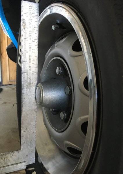

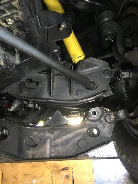

control arms and had bushings and new pivot shafts pressed in, before having the old stuff removed. I also got upper control arms from pst. I told the alignment guy that the ride height was not set yet.
He called me out to the shop area and explained that with both cam bolts out as far as they would go, there was still a -2* plus on the camber and told me that something wasn’t right and thought maybe the new uppers were too short.
Well I took the car home (71 sat) set the ride to about 1 1/2 inch and I’m now at this, about 1/4 inch inward at top of rim.
These lower control arms (installed) are supposed to be for 70-72 b body, but maybe a little bit long its hard to tell. The holes for the shock absorber bolts don’t look the same for sure. Was wondering if the 1/4 inch would translate to about 1 degree negative camber, or go back to the old lowers that are in fine condition except for bad bushings.

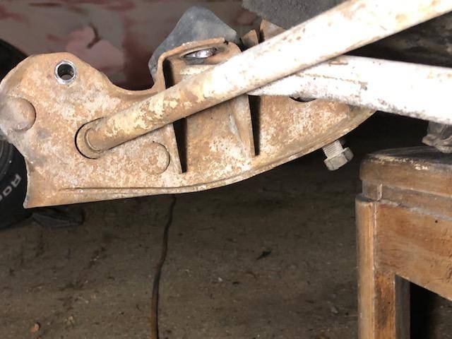

I think that you have control arms for an A body on the car!
Oddly, the A-Body control arms are 1/2" longer. Circle track guys would use them on B-Body cars to get crazy amounts of negative camber for better cornering.

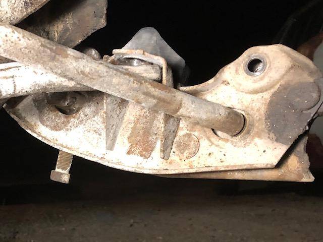

The A-Body LCAS have that flat spot along the middle on the bottom edge. The B body LCAs have a gentle curve all the way along the bottom, sort of like the curve of a large banana.

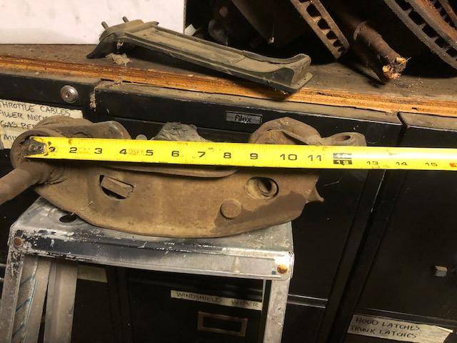

Check this out...The arms I see in your picture look flat across the center of the bottom like an A-body arm:

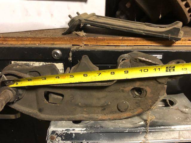

Now take a look at the measurement.
That is approximately 12 1/2" center of mounting pin to ball joint.

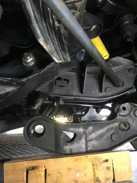

Below are B body arms. Notice the curved bottom of both.
Now look at the measurement :
This is approximately 12" even compared to the 12 1/2" on the A-Body LCA.

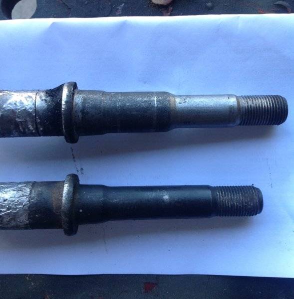

Are the pivot shafts the same for A and B?
No. The pivot shafts are different to dissuade this sort of thing from happening. The lower bushing is the same though so if one is dealing with a pile of parts, it is easy to make the mistake.

Yep, those are the ones. I was thinking that all the hard work was done on them and they have new pst pivots and bushings, but now, from what your telling me, the shafts are wrong for a's.

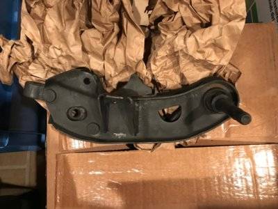

The shaft on top was taken from my 71. The one at bottom is from the purchased control arm (a body). Now,what year would the purchased arm be? Every one on eBag that has sway bar tabs, has them out near the wheel. I'm lost.

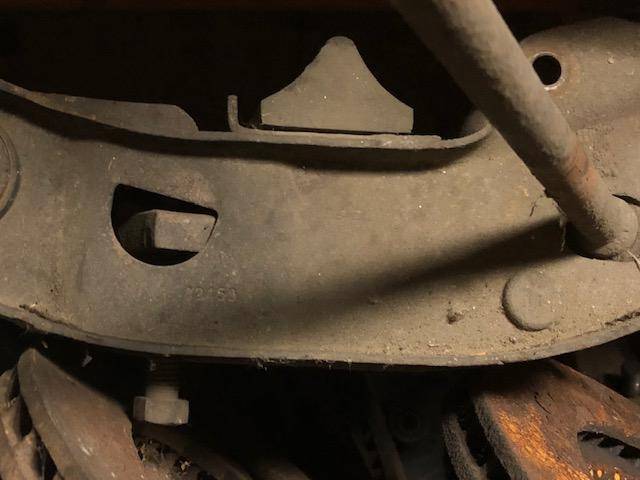

I'll have to look at my LCAs out back.
Possibly 73-76 a's (found old ad)
The lower control arms have a stamping in them on the front by the rivets somewhere to identify them. VL for A-body and RW for B-body
Yep, sure enough VL on bought ones and RW on originals. The left one has LF and the right RF stamped below the RW.

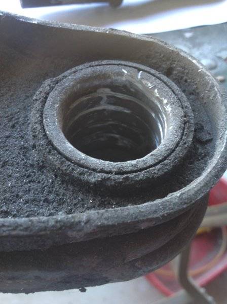

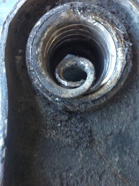

Getting practiced on removing outer shells with dremel cutting wheels, diagonal wire cutters and vise grips.
Easiest way, is to get the right size coarse tap (don't remember the size), that will clear the bushing hole.
Turn the tap in, at least halfway into the bushing shell, and press against the end of the tap. Slips right out!
