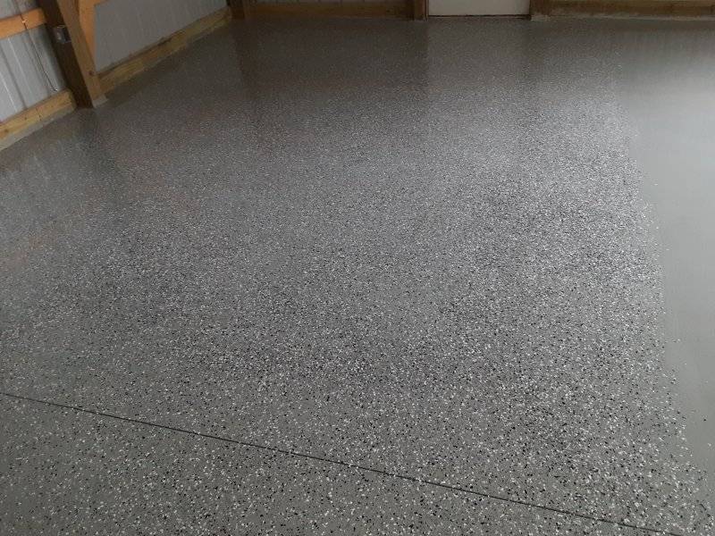

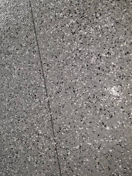

My floor has a decent texture but not so much it shreds mops.
Was that "built in" to the floor epoxy or did you need to add it? I have never done a floor, and quite frankly, I have been scared to try.

I never treated my garage floor (it is still bare concrete) because I was afraid it would be too slippery if it got wet. I heard some say to mix sand in it so you have better traction. Is your floor slippery when wet?
It is some but not bad. Yes, I've done the sand thing before and it works. Thank you, I wish it was finished but with all the holdups, it's taking forever. It'll be 2 years August 1, since we started moving out of my old shop. Good news is I've cleared out of 2 of my 3 storage units. That was a relief.

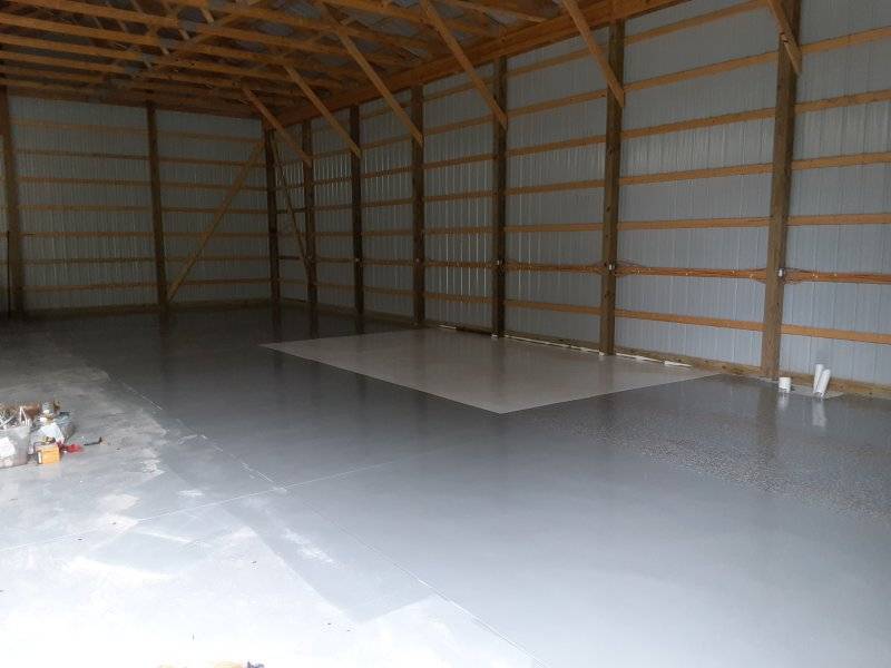

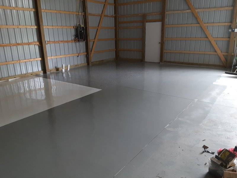

Ok, got back from vacation and everything was sitting on the back porch. This time they boxed the color separately from the heavy paint jugs. I called around to friends and everyone was unfortunately busy except myself and Neil. So off we went out to the garage to get this done, with the proper paint this time. So we started by painting the gray floor for the office first, as it was a very thin coat, as we are clearcoating it. We then sprinkled the flakes on it(another story, I have about 50 lbs of flakes left, as I thought we'd flake the entire floor and then clear it, but dropping a nut or bolt on the floor would be a pain to find), and moved onto the rest of the floor. I mixed up another 2 gallon batch and we did the rest of the floor. By that time, the paint was dry enough on the office floor space that I went back over it with a squeegee to remove any flake that didn't stick to the paint. Don't press real hard, just glide over it to get the obviously loose flake up off of it. We went to lunch and when we came back, we mixed the clear and put it on. Done! It looks amazing, so much better than the fast dry did. It still dries too fast, imho, but it flowed out and looks good at any rate. I would say slow dry in about 40 to 50 degree weather would be the best temp to apply it in. Not the 90+ we had to deal with.

When the company did my epoxy, they mixed the grit in so it came out even and not blotchy. I went light grey, no speckles as either darker or speckled makes it fun finding small parts, like e-clips/hairpin clips etc on the floor. Light color reflects the light better too. All of my drywall is white for the light reflection too.

Same here, white ceiling and walls. I did epoxy on one of my shops with mixed results. I wanted to try the latest and greatest, so far so good.

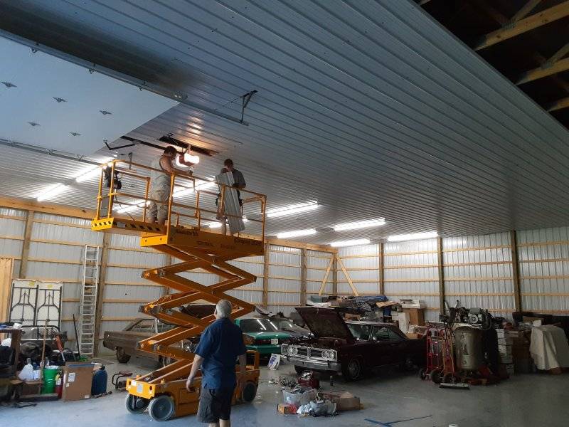

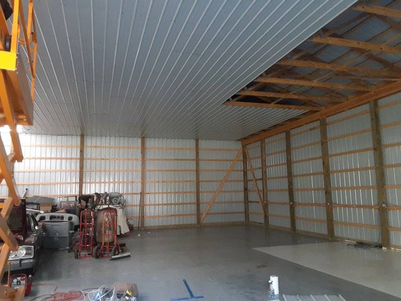

Once the floor was painted, I rented the scissors lift again and my friends came over to help. We lifted the ceiling panels up and screwed them to the rafters. I purposely left part of the ceiling open as it will be the ceiling if the second floor of the rooms. There was about a 10" gap between where the panels ended and the top of the wall. It was really bugging me, so I had a couple partial panels and one full panel left. My math was pretty damn good. I cut it into strips and hung it with a friend's help. Gap filled. I slept ok that night, lol.

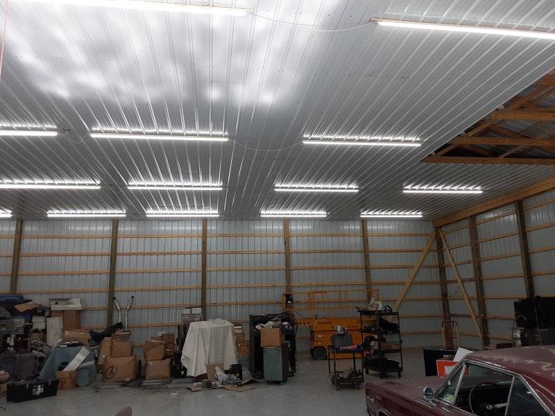

After we got the panels up, I went back to menards and bought more ferring strips and set up the brackets for the lights. I had to order more lights in so I could finish the installs. I ordered 10 more and got the 100 watt ones this time. They are noticeably brighter and will be over the dyno area so that's a plus.
I got up there and started putting up strips, snapping in lights and wiring them up, when I realized that there was a bunch of stuff in the way of me getting to the rear most box in the ceiling. So I started moving **** out of the way. Took me a while but I made a path for the lift to get back to it. I put in the last row and it was done. Looks great and it's bright as hell. I like it so far.

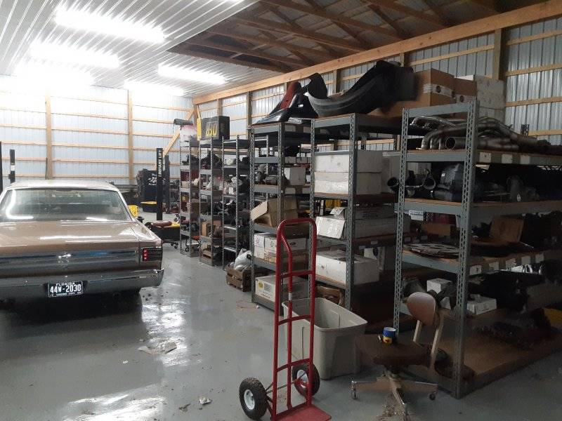

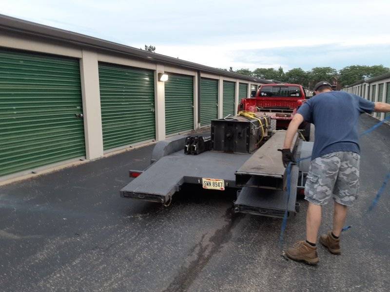

The next weekend, we decided it was time to move the racks and dyno in. This would empty out my second storage unit, the second most expensive one I had, the most expensive one was emptied in December. So motivation to empty it was high. I needed a fork lift to get a lot of the stuff moved, then unloaded and placed at the shop, so for the time being, we just moved the lighter stuff we could get to. We moved oil drain tank, lots of shelving, 2 air compressors, and a bunch of other stuff we crammed into my enclosed trailer.

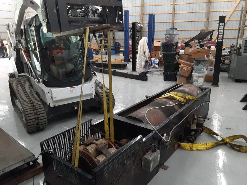

My buddy Sonny, the guy who did my concrete came through for me again and said he'd bring his skid steer with forks over and a second truck and trailer too boot. When I asked him, I told him it would be worth 599 cash to me if he could get this done. He showed up with Dennis and the 4 of us got to work. We loaded up the 2 post racks, the dyno, the waste oil furnaces, and every other piece that was in there. Sonny said, we're emptying this thing tonight, lol. And we did. He even had a broom and leaf blower to clean it up. We busted *** and got it all moved. Still have some work benches and other stuff in the trailer but that'll come out this weekend hopefully.

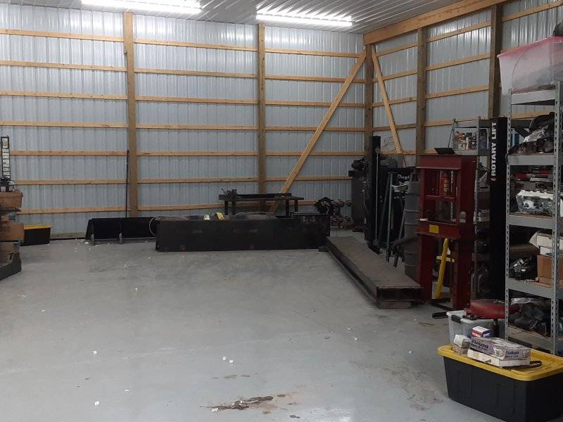

We started assembling shelving units and unpacking totes if parts and crap I've held onto way to long, years and years. After we got to a point, we realized that the way we had the dyno laid out, a car would be way too close to the shelves and the ramps would be close to the wall as well. So we dropped back and punted. I used the pallet jack and angled the ramps towards the garage door. It fit a lot better, gave more space between dyno and the north wall and utilized more of the center space of the shop floor.
I needed my buddy Sonny to come back over and use his skid steer to move the dyno over to the new angle to match the ramps. Hated to ask but I had no choice. He's coming out early tomorrow to move it for me. It'll be nice to have it all in position and ready to assemble.

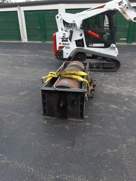

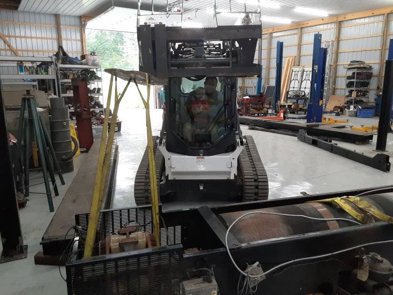

So Saturday morning Sonny came to my house with forks on his skid steer and Neil and marked the floor and maneuvered things out od the way so he could get in to the dyno and the brake to move them. The brake weighs about 850 or so and the dyno is about 2600, meaning there was no way we were moving this without his equipment. Thankfully he is a great guy and was willing to help me. He brought his oldest boy with him. He has twin boys at home that are a few months old now. Anyway, we angled the dyno and I think we got it right where we wanted it give or take. Now begins the assembly of the racks. I'm going to try to find someone who will level, anchor and adjust the racks for about 200 or so each. This 4k crap for a day or 2 of work is stupid.

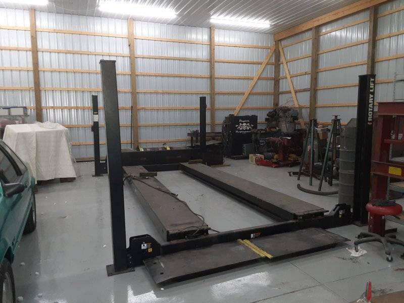

We finished assembling the 4 post rack and now that is ready to be wired up and let the guy do his thing.
We moved onto the 2 post racks and after a lot of thinking, discussing and positioning and repositioning, I think we have a plan. We got 2 in position and one of them is pretty much bolted together, just need to run cables and hydraulics and it's ready. More tomorrow.
