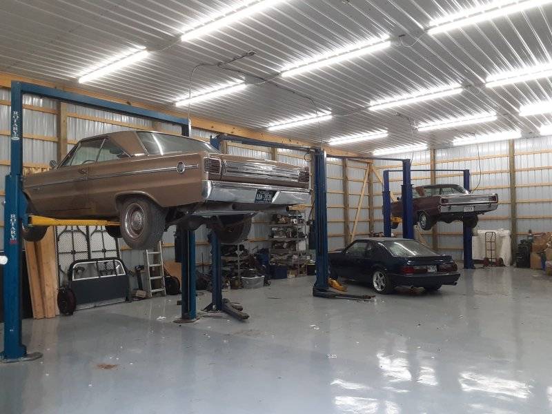

Pics, Finally! The damn phone didn't delete them this time. As you can see it is far from perfect, but it safely gets current to the racks. I'm happy. It all works and doesn't pop a breaker.
First pic is of the last completely assembled rack.

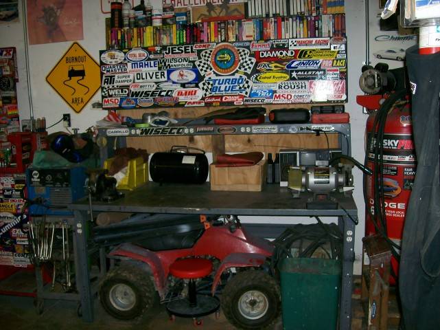

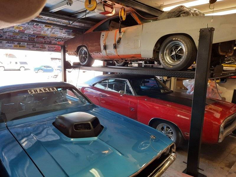

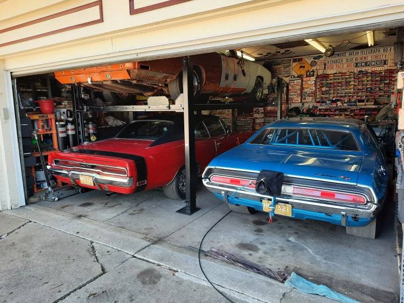

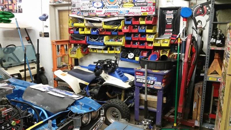

Damn, nice shop now that is finished. I envy you guys all with big shops to work in. I have a 2 car garage that I squeeze 3 cars in along with all my parts, equipment, quads etc. However, we have built alot of cars out of my little ole garage.

You are neat and organized. That is my end goal. We worked for 2 years out of one bay of a 2 car garage on our backs and jackstands. It sucked. I started in a big 2 car like yours and have gone from space to space until I am now in my own place. No more rent, no more asshole landlords, no more double bills of electric, gas, water, etc. I am happy.
Your Challenger looks cool. So do your chargers.

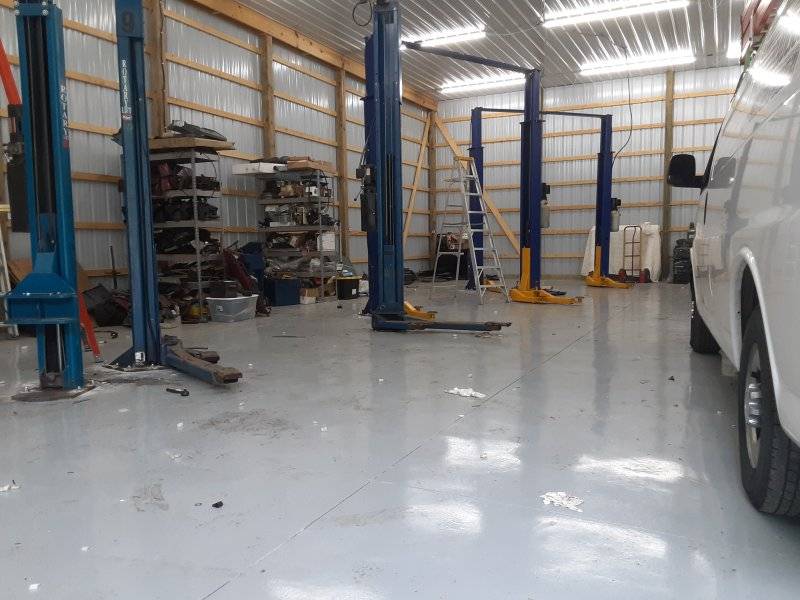

Guy showed up at 11 and left a little after 5:30. He got all 5 racks installed and the dyno anchored as well. I'm really stoked. I lost hope on more than one occasion, but it finally happened today. I couldn't wait to get the cars up in the air and see how well the racks worked. No more laying on my back for me! Next is running air lines and connecting up the air compressors, then wiring up the Aux Panel and wire up the dyno and rack.

SAWEEEET!!!! :thumbsup:
What a great space it is becoming!

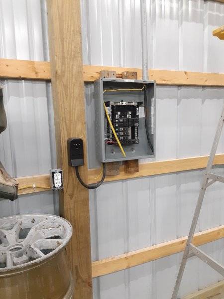

We hung the Aux panel yesterday. The past 2 days have been 2 steps forward, 5 back since yesterday, guess I ran out of good luck for the time being. This is all for now.

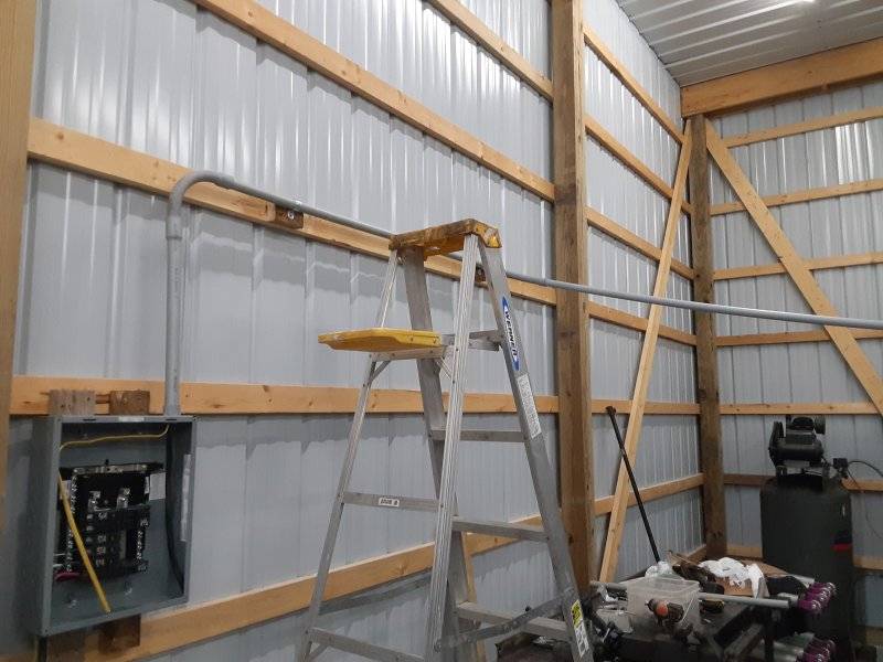

Ok, we wired in the welder outlet and the 110 20 amp outlets for the back wall. Then we started running the 6g wire for the dyno brake and the 12-2 for the 110-20A outlets to plug the electronics into. We used 1" conduit, which in hindsight was a bit small, but we made it work. We did not have enough wire so, the initial layout did not work. We had to disassemble it all, cut some of it out and then run it all over again. At least this way it will have enough wire. It was miserably hot so we called it a day around 4 pm. At least the air compressors are wired up and working. Now to run air lines.
Oh, and a side note, once again the obvious choice was wrong with using 10-3 wire for the compressors, they are just like the racks and only use the red and black wires, so 10-2 would have worked and saved a bunch of money.
