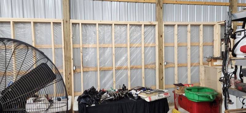

I went out to the shop today and snapped a pic of the wall attached to the 6x6 post.
And the plumb bob.

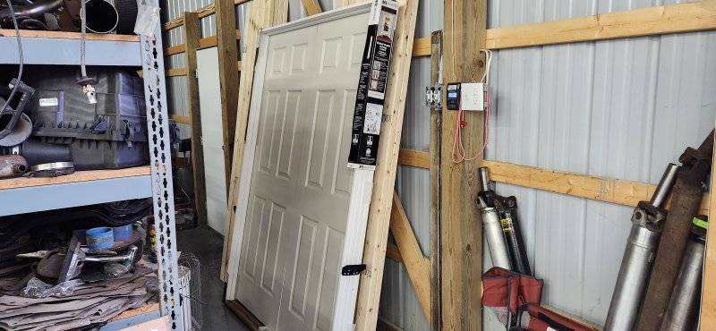

My wife rode up to Lowes with me so we could shop for double doors to use as the entrance to my engine room. I use double doors, 60" wide so that any engine stand will fit through the doorway without issue. Heck, the engine hoist can make it through there.
The stores weren't very crowded, so we got help quickly and the guy looked on their site for double doors and priced it out for me. It was 630 bucks plus tax and it was 45 days out, crap! I thanked him and said I wanted to shop around. Next stop was across the street at Home Depot(pronounced 'DEE pot'), and again, no one was in the store and we had 2 guys eager to interact with other humans even if it meant doing their jobs. I asked for double doors, he asked what size, I replied 60x80 and he said right this way. Around the corner and there they were. 279 plus tax. Sold. They loaded it on a cart and bid us farewell. A nice young gentleman asked if I needed assitance getting it into my vehicle and I said yes. He helped albeit struggled, to lift it up into my truck all the while I'm holding my end up and balancing it, but we got it in the truck. Got it home and my neighbor Jeep Mike(his nxcoupe given name) came down to help unload and shoot the shh er bull for a bit. That's all for now.
The stores weren't very crowded, so we got help quickly and the guy looked on their site for double doors and priced it out for me. It was 630 bucks plus tax and it was 45 days out, crap! I thanked him and said I wanted to shop around. Next stop was across the street at Home Depot(pronounced 'DEE pot'), and again, no one was in the store and we had 2 guys eager to interact with other humans even if it meant doing their jobs. I asked for double doors, he asked what size, I replied 60x80 and he said right this way. Around the corner and there they were. 279 plus tax. Sold. They loaded it on a cart and bid us farewell. A nice young gentleman asked if I needed assitance getting it into my vehicle and I said yes. He helped albeit struggled, to lift it up into my truck all the while I'm holding my end up and balancing it, but we got it in the truck. Got it home and my neighbor Jeep Mike(his nxcoupe given name) came down to help unload and shoot the shh er bull for a bit. That's all for now. View attachment 1583655

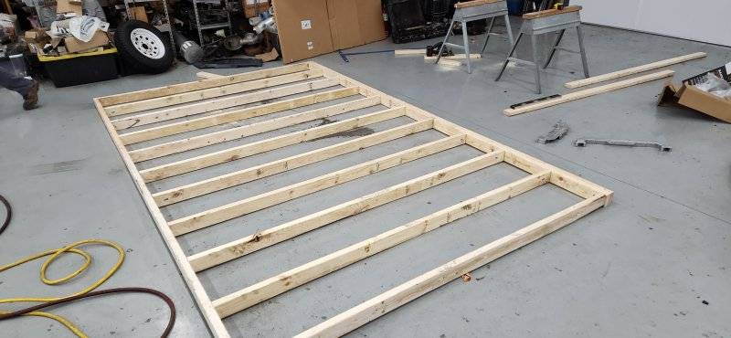

Productive weekend! We started on the front wall of the engine room and made good progress. After we laid it out, I called my buddy that is a construction manager as I was really having second thoughts about how to get it square, make sure everything was the correct length, etc. So after a pep talk, I was more confident with proceeding, thanks Luke. After giving it a lot of thought, I realized I needed to measure the length of the front wall, and then lay out on the back wall that length and run the other side wall perpendicular out from there.
So short story long, we started building the outside, rear wall inserts and figured out where we needed to out 4 2x4s so we could attatch the side wall to it at the proper distance from the other side wall.

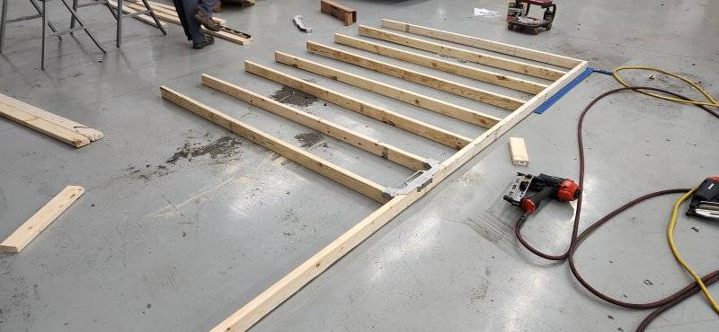

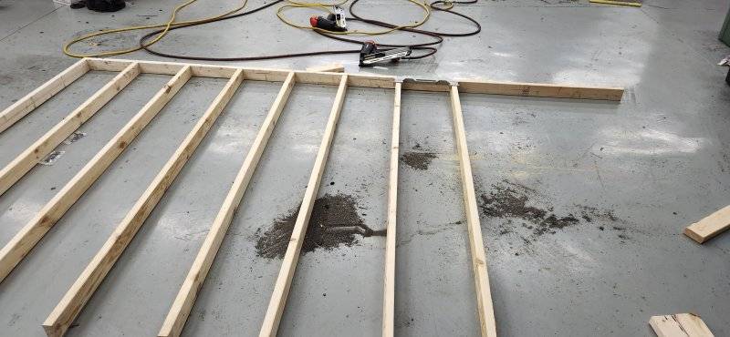

Here is us starting on the front wall. We are using a double door so after talking to Kern and Luke, I went with a 2x12 for the king header and we used 8 2x4s for support and framing out the door opening.
The 2x4 across the door opening is for when we lift and move the wall into place for rigidity.

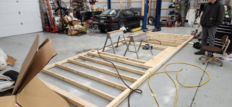

We got an early start Sunday and got right into building the rest of the outside walls built and insralled. We flip them and put the plastic vapor barrier on using my new HF stapler. That thing works great, I can make short work of it just dragging it along and pulling the trigger as I go. We got them done and installed.
Then, after a long lunch break as I was beat, we started on the other side wall and slid it into place. Then we made sure it was all square.
Pic of the completed front wall. We will need 2 other folks to help us to get this into place as it's frickin heavy.
