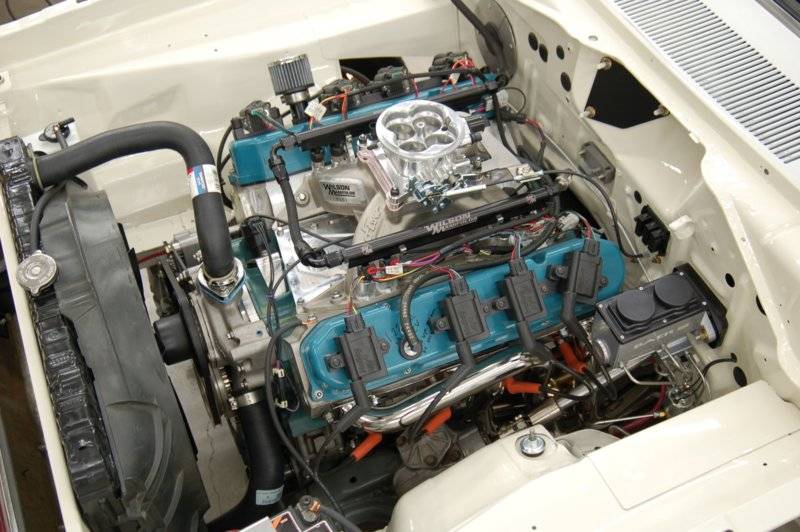

Yes, race gas kills the O2 sensors. We've switched over to building pump gas engines for most customers. You can easily make 700+ hp with a pump gas Mopar big block so not much reason these days for high compression. The block is going to break if you push it much past 700 hp so what is the point?
I have a 512 inch low deck in my Duster that makes a little over 600 hp. It is EFI with coil packs and has wide band sensors. Runs on unleaded premium.

Nice looking setup Andy! (you could remove the radiator hose stickers)
