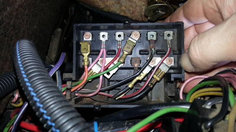

For switched source inside the cab can be used the accesories circuit or RUN ( ign1 ) circuit. I can't say certainly if there is a provision ready for it down the dash on a 65. On laters, is really normal get some provissions around ready to be used.
Lot of 60s fuse box got terminals with a male prong to get there a new source plugged there and prottected by the fuse where is being sourced.

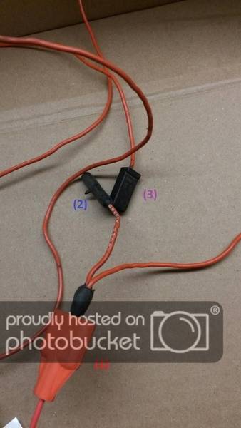

but MAYBE you can find hanging around a provision like this ( but not orange, orange is dimmer ilumination... should be tan wire maybe ) to get some stuff sourced:
Guessing electric gauges, not mechanical? Then you could do like Nacho-RT74 posted and get the switched and fused connection from the fuse block. Not sure if that year has accessory, but I think the Radio fuse circuit should work?
