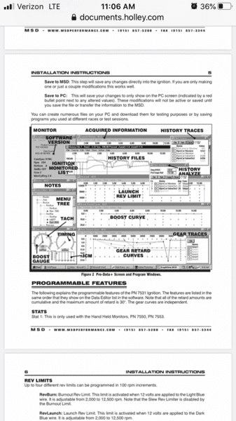

Most modern ignition systems have provisions for this. Once you change engines, I’d recommend going to the MSD ignition and get something with built in retard capability. The 7531 is excellent for multiple gear/nitrous retards and they’re stackable. It’s light years beyond the prehistoric orange/chrome/gold box junk.

The MSD 7531 uses a laptop to program ignition maps and also has limited data logging capability if you wanted to run a map sensor for manifold pressure it’ll log that. You can also run it in the crank case and it’ll let you know when you rattle the rings because the tune is off.

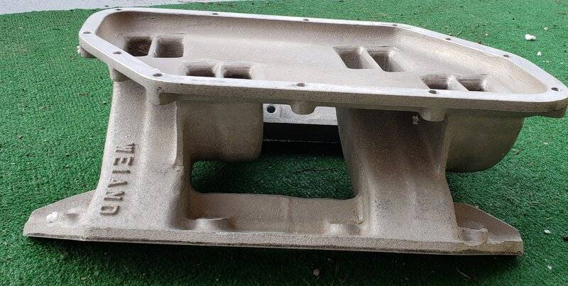

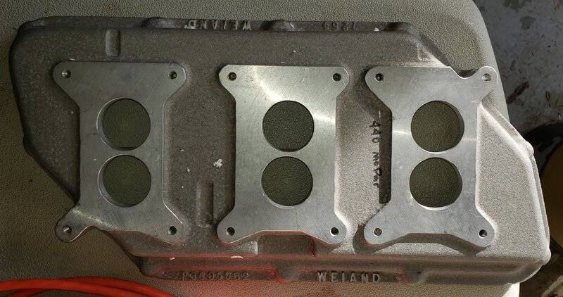

The guy I bought the Weiand intake from:

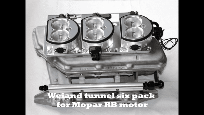

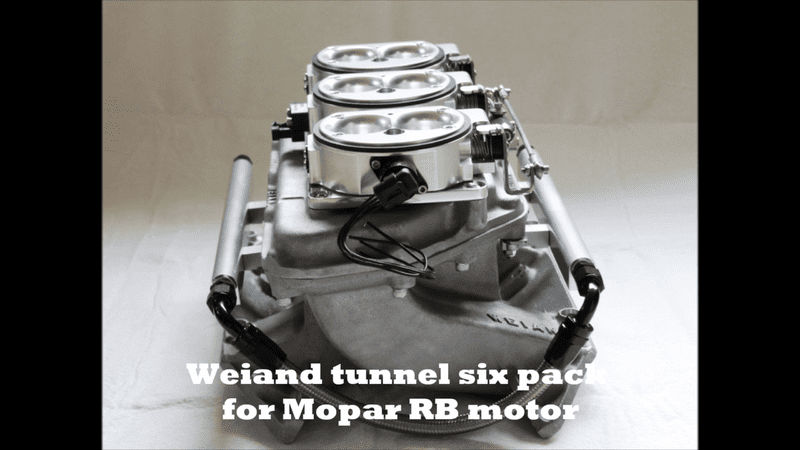

he has "supposedly" NOS mechanical 3x500 CFM 6bbl setup, and while I may be able to "get a deal", honestly if I make a change I'd rather just go all in and get the F&B direct port injection 3x2 EFI setup:

The guy I bought the Weiand intake from: View attachment 964359 View attachment 964360

As far as EFI plan, you see it in those pix. F&B 3x2 EFI DPI and whatever control system I can get support on, that Bruce at F&B and maybe my builder can agree on.
I just don't know if I can swing the $5,500 for the EFI, fuel pump or pump/tank combo, fuel lines, controller, on top of the cost of the build. I may have to start with the Promax modded Holley carbs, but it would be ideal if I had the EFI for the builder to dyno my engine with!

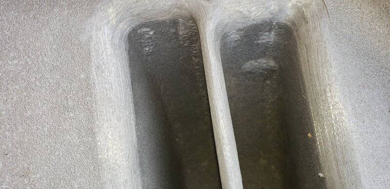

One of the BEST reasons for going to the F&B direct port injection 3x2 EFI system, other than EXTREME "bonus coolness points" :D is that the "problems" inherent in the Weiand 6bbl intake are all ELIMINATED by making it a "dry manifold". I have the ONE edition of the Chrysler Performance manual that has ALL the race teams published modifications for ALL of the aftermarket intake manifolds available at that time, including the Weiand 6bbl. I'm actually more inclined to follow the advice of the guy who has the pictures of his mods to the intake featured in the Victory Library article on the Weiand. Several reasons, but mainly because he got better results than the Chrysler Performance bulletin mods, and they are more easily reversed, for the day I convert to EFI.
I have been told by a few guys who have run and are still running (10+years) the Weiand intake to try it as is and go from there. The only mod that has been done is the sharp 90° angles from the plenum floor into the runners have all been nicely radiused, as per the Chrysler Performance bulletin, and THAT doesn't hurt ANY application.
Look at those pretty radiused intake runner ports...:thumbsup::bananadance::drinks::D
I intend on having the runners further cleaned up, since they have to be brought out to :lowdown:Max Wedge size for the TF 270s, and I'm told to check for runner to head port alignment (I'm going to use a scope camera). So the imperfections that are visible will be taken care of in the future.
