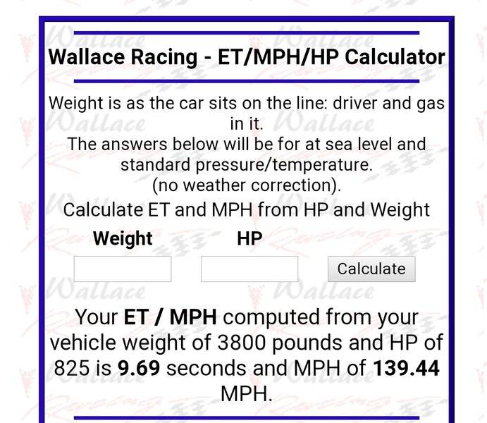

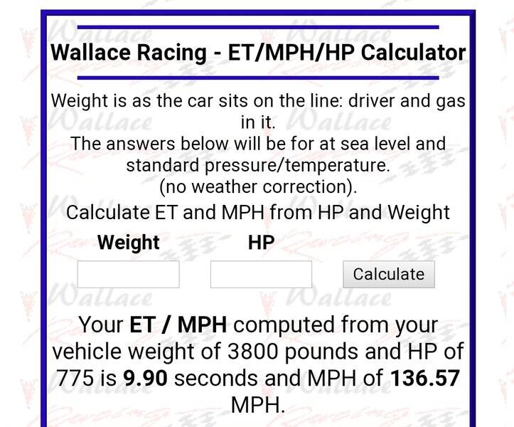

To show y'all that I make an effort to get some answers myself :) I plugged some numbers into the Wallace racing calculator. I realize this is an estimate, and is based on a good run. VERY interesting!
Baseline, using 675 as my HP, I get this:
Adding a "100HP shot" if I get 100HP:
So that would get me from "the 10s" into "the 9s" which made me think about my buddy's yellow 'Vette and his 9.8 run at 139 MPH, so I tried a "150HP shot" and that gives this:
Like I said, that is a guestimate, and assumes a good run.
Looks to me like a 100-150 shot, especially if a well built engine doesn't have to "suffer" from nitrous specific build spec "ring gap" or other "off the spray" detrimental mods is WELL worth having that option available!

a 250-300hp you could go to www.wallaceRacing.com
& play with #'s see how much it needs to work & achieve it
250hp-300hp N2O kit real HP, not advertised BS

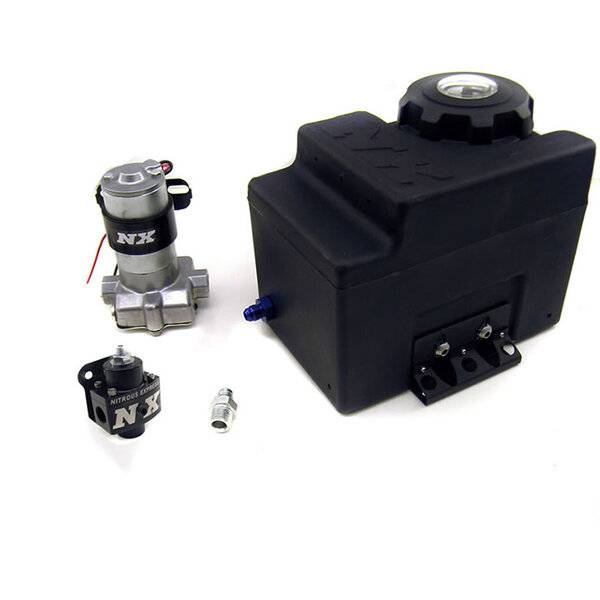

I would definitely have a low fuel pressure sensor wired into the fuel system at the fuel solenoid / fuel solenoids... so it will shut off the system. It only takes a few seconds to melt down a motor. there's a lot going on in a 9,10 second car. I always wired in pro lites to my low pressure sensor .oil system , fuel systems. a light will get your attention instantly. Good luck
For those not familiar with the Nitrous Express S.A.F.E. stand alone 1 gallon tank, electric fuel pump, and pressure regulator, (there are several, this one is ideal for carburetors) here's the one I've been looking at. I would have to talk with Nitrous Express and see if it can be upgraded and how, if I switch to the F&B 3x2 EFI/Direct Port injection system, or is there a better choice that will work with the 6bbl carbs now, and the EFI/DPI later.
I AM ABSOLUTELY SOLD on this concept!
I think it is BRILLIANT!
From the description:
The Nitrous Express SAFE (Stand Alone Fuel Enrichment) system improves the performance of any nitrous system. The SAFE system includes a one gallon, high strength, composite fuel cell that can be mounted in most factory battery trays without modification. This version of the SAFE System includes a low pressure external fuel pump and non bypass style regulator.
Here is something I alluded to in my post, if, for example, the 1 gallon of fuel is 100LL AvGas or Sonoco Turbo Blue 109, etc: When used with race gas, the need to retard timing is significantly reduced. The SAFE system reduces the need to upgrade OEM fuel pumps, and will completely eliminate pressure drop at the fuel rail in EFI vehicles.
https://www.nitrousexpress.com/stan...temsafe-external-pump-and-regulator-15003.asp
You can easily do your own stand alone system for a lot cheaper and it is just as good. We use a JAZ Jr. Dragster fuel cell and a small electric pump for our dedicated supplemental fuel system.

Here are just a few scenario's of its projected performance @3800lbs all in, 4.10's?...28" tyre?
at 700fwhp,>
60 Foot E.T. : 1.42
1/8 Mile E.T. : 6.46
1/8 Mile Trap Speed : 105.23
1/4 Mile E.T. : 10.24
1/4 Mile Trap Speed : 131
1/4 Mile Trap RPM : 6,445
at 800fwhp>
60 Foot E.T. : 1.36
1/8 Mile E.T. : 6.18
1/8 Mile Trap Speed : 110.02
1/4 Mile E.T. : 9.79
1/4 Mile Trap Speed : 137
1/4 Mile Trap RPM : 6,738
at 850fwhp>
60 Foot E.T. : 1.33
1/8 Mile E.T. : 6.05
1/8 Mile Trap Speed : 112.26
1/4 Mile E.T. : 9.60
1/4 Mile Trap Speed : 140
1/4 Mile Trap RPM : 6,876
but these no's are assuming a good hit off the line and run through to the traps which I doubt will be the case unless you power shift it.
just my thoughts.
