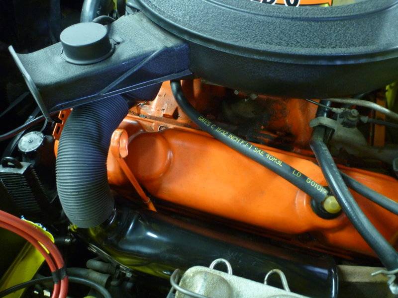

Does it have a "heat stove" connection between the exhaust manifold and the air cleaner?
It was originally a paper like tube connecting the exhaust to the air cleaner with a vacuum actuated door in the air cleaner snout to draw in warm air until the engine was at operating temp. I think 74 was around the era when these were introduced.
'70 actually... pic of what Don is referring to !
