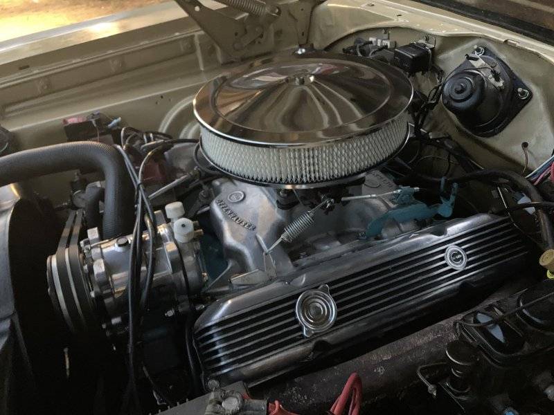

Good eye. the pic is of my current set-up. I haven't done the swap yet. Still gathering parts.
But, like you, I'll be going to the 440 source heads and the original Performer. I'm going to grind off the logos on the intake and paint both the heads and intake engine color.

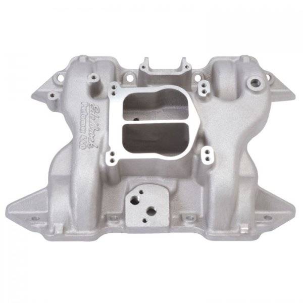

Then you will be fine with Edelbrock's #2191, low-rise which greatly improves torque over a wider rpm range for better throttle response from off-idle through 5500rpm (smaller runners equal more air speed velocity / larger runner equals volume). The Performer intake manifold is ideal, for real world street cars, who live in the low to mid RPM range.
Oh, also, stock is about 4.2" tall. The Performer and the CH4B are the same @ 4.8" height, measured at the tallest point. So, you will gain a bit of height with the swap. The Holley SD (5.25") and the Eddy RPM (5.28") are even taller.

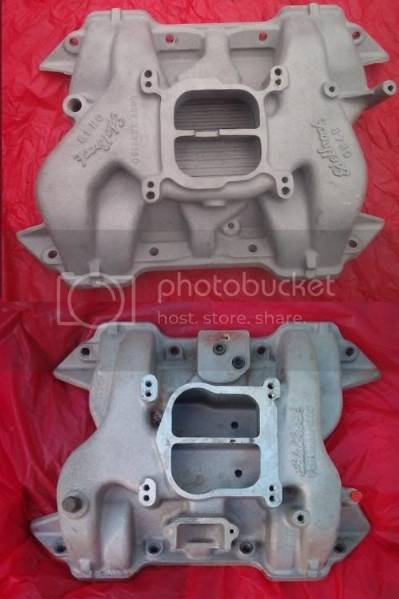

First is a pic of a Stock 67-69 4bbl vs Edelbrock Performer. You can see similar runner sizes between the two (air speed velocity), but the performers seems to have a more flow friendly layout. Also, spread bore acceptable.

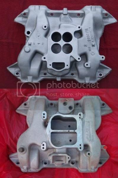

Next up is the stock intake vs a CH4B. The CH4B has what appear to larger runners and sweeping runner design vs the stock piece. Remember, large and long runners equal volume. The CH4B also loses the stock choke mount and EGR mount.
Finally let us look at the Performer vs CH4B. The Performer also will accept at spread bore carb without modification but the CH4B will have to have an adaptor for a square bore, but it does have enough meat to allow it to be "hogged out" to accept a spread bore, if so desired.
I suspect that the only reason that the CH4B was discontinued was for the versatility to use either a square or spread bore carb and retain the divorced choke and EGR. For me, the Performer is more versatile and more accessible. You can buy a brand new Performer.
