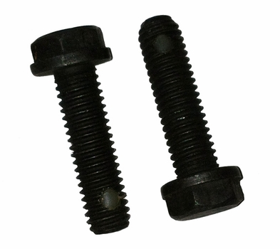

Never had any problems with over filling my oil but 1/2 quart never made anything leak. Do you have a PCV system hooked up? If not, this could cause leaks in places where it shouldn't. Is it blowing the dip stick up out of it's tube? The fuel pump has special bolts....the heads are just a bit rounded for ease of getting a socket on them at a slight angle. If your PCV system is right, I'd try a new pump to block gasket.

Those special bolts are easy to spot. About 2" long, but main dif is the heads of the bolts. Built on washers, with smaller hex heads, if you can picture it. Only ones like that on the motor.

Hex heads? You mean that you need an allen head wrench to install them? If so, mine definitely aren't those and if I remember, I use a 1/2" box wrench to tighten them. Mancini Racing has these.....
