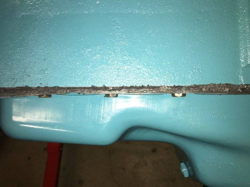

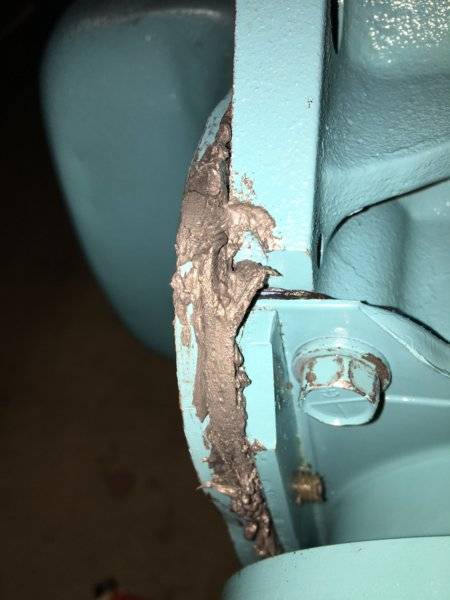

Well, I created this lovely mess today. I torqued to FSM specs 15 Ft. Lbs. The rubbery gaskets that came with the MP windage tray squished out under a few bolts... No way will this F'ed up combo will seal. :BangHead:

What pan are you using? Is the pan rail true,,,,That will hep determine which gasket is best for you.
I'm using a clean factory 187 pan. I thoroughly checked for straightness and hammered a couple small issues. This pan was not previously over tightened - no dimples at bolt holes. Of course now it's dimpled! 15ft lbs. folks on a quality torque wrench.
FWIW, I never torque oil pan bolts to specification. I use a light coat of gasket sealant snug all the bolt til sealant comes out slightly and call it good! Never had them leak! 440'
Sure looks like too much torque. Also looks like the pan is bent now, too.
You certainly have enough sealant on that gasket, too. :)

I have to come up with a new plan. I know I used too much Ultra Black, but I also have to use different gaskets!
4 layers of RTV builds up even if you spread thin coats.
If the tray is nice and straight,a thin gasket works.I glue it to the scraper with just a small schmear of grease on the block. For you, a thicker gasket between the pan and tray is needed to conform to the pan with just a bead of "the right stuff" or something better than some cheap silicone. I don't like anything oozing to the inside of the pan so lay the bead to the outer edge.Snug it till it starts to ooze and STOP. Let it be overnight and tighten in the morning!

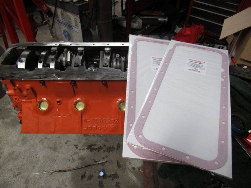

Here's my plan:
1. clean everything again, straighten pan and tray
2. mask tray with blue tape only exposing contact area and Loctite Hi-Tack sprayed lightly and stick a gasket to each side. Let it lay flat on bench with a little weight holding it all down. Let it set.
3. Silicone on block only on front corners and above real main seal.
4. Silicone - on the oil pan, and carefully finger tighten, then 1/4 drive ratchet with some finesse!
What do you guys think?

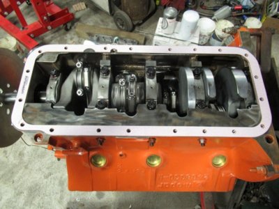

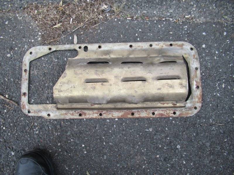

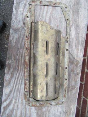

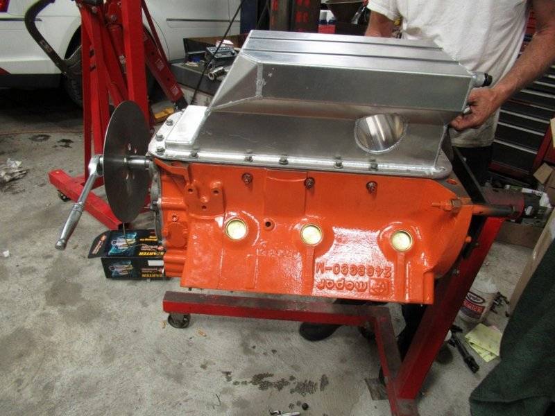

This jarred my toasted memory. 30 plus years ago there was not the choice in gaskets nor the quality we have today.They were all pretty much CORK! Used to use thin white string to hold the gaskets in alignment to get the bolts in. I still have an old tray with battle scars:lol:
I used the Summit windage tray with the embossed silicon strips. I trimmed the return slots a wee bit but other than a small dab of sealer at the corners it fit and has been leak free for over a year now. Plus they say it is reusable, I would not bet on it though.
I seriously considered that composite windage tray from the beginning, but it seems as if 50% of folks say they're good, 50% not so good.
Aftermarket flat rail oil pan = yes.
factory pan = not so much...but possible is what I gather.
I have a stamped steel pan with the reinforcing ribs and it seals great... No sealer whats ever....
