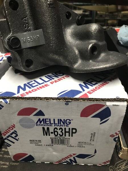

Here are all 3 oil pumps a Melling M-63 , M-63HP , and the High Volume pump off my 1970 383 HP motor.
From what I understand the only difference in the M-63 & M-63 HP is the spring in the HP is stiffer creating more pressure and the HP has a tag on it stating such.
The High volume pump is a taller housing to accommodate the taller impeller to pump more oil. I did read somewhere that you should not run the HV pump at W.O.T. for more than 30 seconds at a time or you could suck the oil pan dry so maybe others here can debunk / verify that as I am not sure.
Yes you can suck the pan dry with a HV pump...it needs a larger pan and a windage tray can't hurt either.
