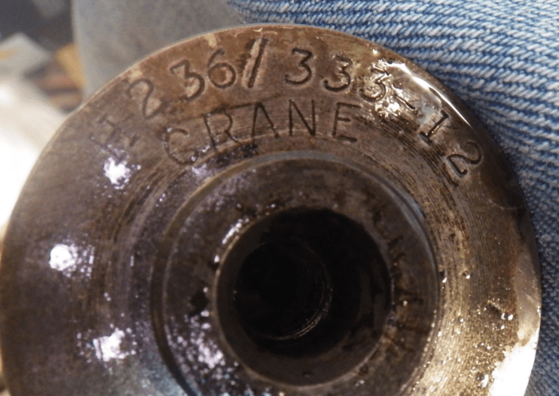

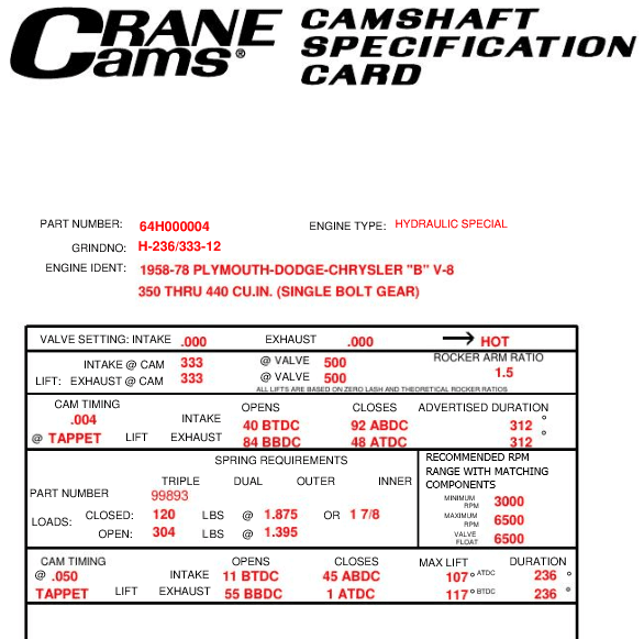

Pulled this grandpa cam out of a 440 today. Current catalogs I searched don't list any 1 bolt cams.
Anyone happen to have an older Crane Catalog with the year and specs on it they can post up for me?
Stamped.....
Bolt end....….H-236/333-12
Back end...….K1162
TIA
Educated guess....236° duration at .050, .333 lobe lift, (.500 at the valve with 1.5 rockers, probably slightly less with original mopars), 112° lobe seperation, hydraulic cam. Very similar to a purple shaft .509. K1162 is likely the grind #. Probably a Crane commander, 300° /.500 advertised.

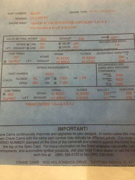

Went ahead and contacted Crane. It kinda' surprised me, they sent the card info PDQ..........
ok 107 +117 = 224 / 2 = 112 LCA looks like ground 5 advanced
1ntake closes 92 abdc@.004 use for dcr calks or 85 @.006
overlap is 40 + 48 =88
maybe 305 @.006

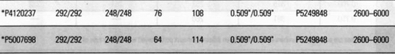

and close to that mp cam 292@.008 maybe slightly more seat
its a .842 grind so no surprise that the mp is bigger @.050
.200 would really tell the story
shoul rev well

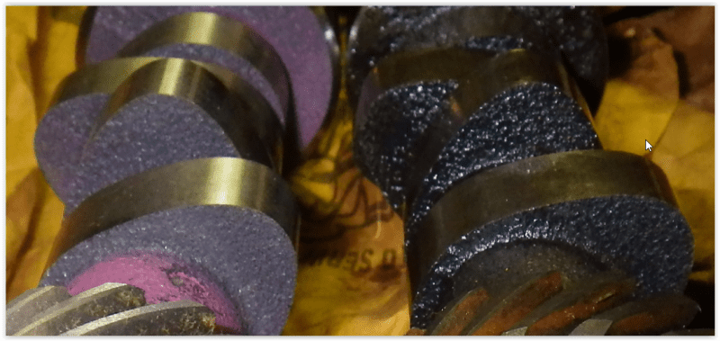

if you have both cams shoot a pic of the lobes
most likely it will have a more pointy nose than the mp, biggr noses wear better and less chance of valve flor
but being a crane should be smooth and rev well, just can't breath as deep as the mp
with spring shown it can't be too agressiv
ps the mp overlap is @.008 (ish) so to compare you have to adjust
Nice of crane, I'm impressed. I really helps having the actual timing events. Looks like a decent hot street cam for a 440+inch engine. I don't think I'd use it in a 383.
I did the same thing with my Crane cam. The numbers can be a mystery sometimes. On the front of mine it just said “CCH-290 NC”, so I wrote Crane and I was answered in a couple of days, 2 I think.
I thought it odd and a bit more so now that I see advertised cam tappet timings of .004 vs .007, yours vs mine. Pretty light spring as well.

Interesting. Two crane hydraulics, both 236 @.050, with .500 lift (roughly) and one advertised at 290° and another at 312°. I wonder which one sold the best?

My bad, i didnt see that one was a small block. Still, both 1.5 rocker motors, I wonder why 22° difference in advertised, for the same 236° at .050?
As was mentioned earlier it appears Crane changed the measurement based on how much lift they took the advertised duration measurement at... One is taken @ .007 the other is taken @ .004. Theres a reason people who know what they are doing ignore advertised duration & go straight to the @ .050 numbers..
Do you really think there was 22° between .004 and.007? I think they just pulled the 312 advertised number out of their a$$ for sales purposes.
When the ramp is shallow it can hide allot of duration on both sides of the lobe... I do admit 22 degrees seems extreme, 12-15 wouldn't surprise me at all... 22 yeah that might have been pulled out of someones ***... If you look at the cam cards theres allot of other minor variations
Nothing bad there by ya'. You guys are teaching me! Thank you all!

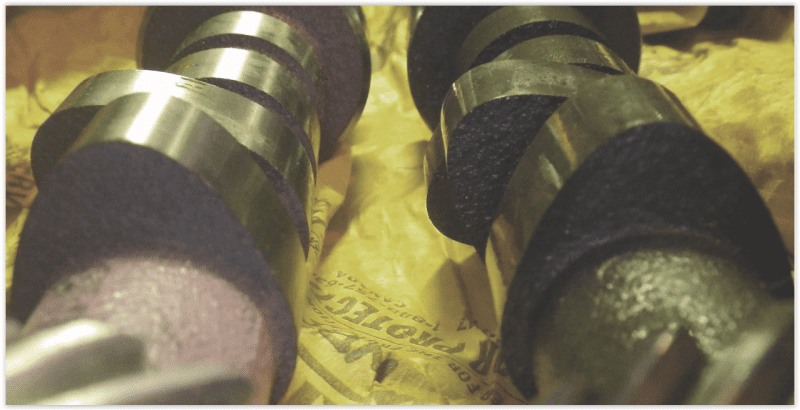

Side by side.................
camcraft shows 7 degrees between 004 and 006 so maybe 9-10??
looks like the purple shaft has a fatter nose
how's everyone else's eyes?
neither looks super pointy

Yes the MP is fatter.
BB vs SB?
Yes.
Different ramps.
