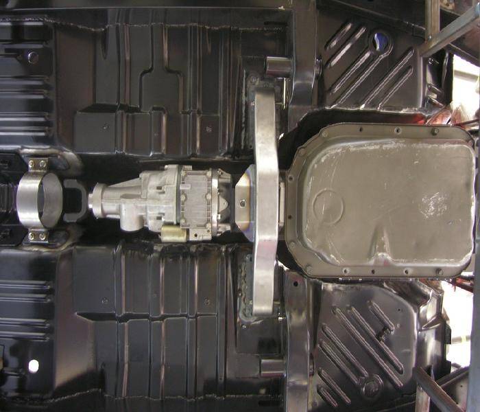

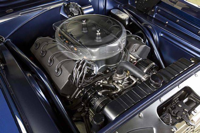

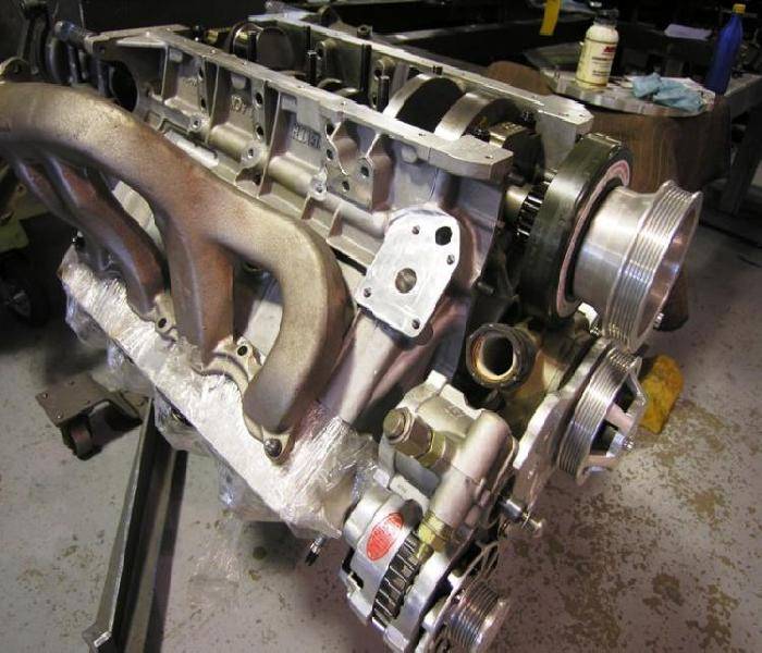

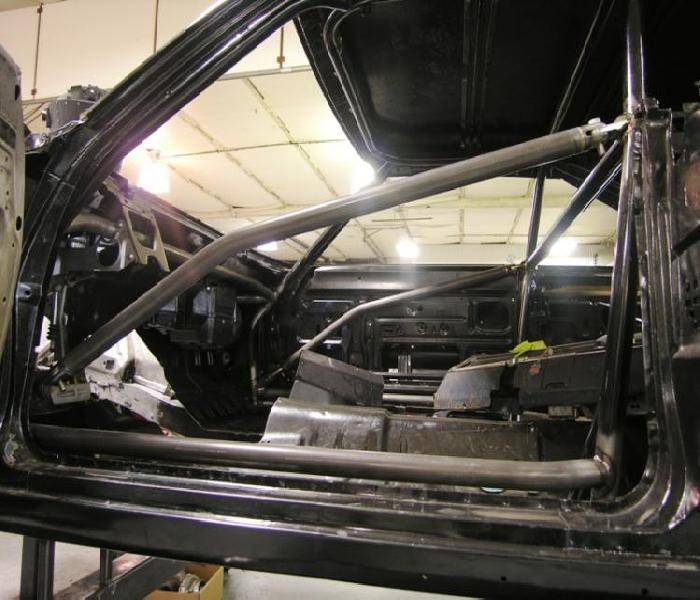

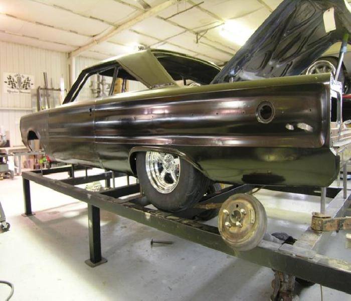

66 Belvedere below, bad *** sleeper, don't be fooled by the appearances
looks mild but it's a 1500+ hp twin rear turbo'd FI beast
