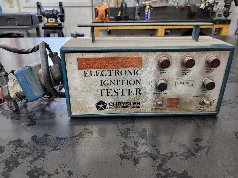

I've never used it, but it looks neat sitting on my garage shelf.
