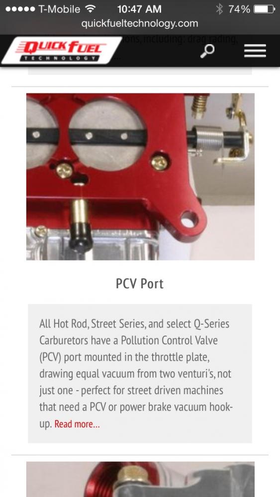

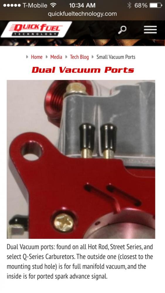

So I got to reading about vacuum advance and the ported vs manifold vacuum connection debate. Learned more than I did last year. Sooooo... This morning I got to looking at my quick fuel 735 carb and low and behold that vacuum hose was hooked up to the PVC valve port on the side of the carb. I reconnected it to manifold vacuum (closest to carb mounting flange at front of carb) , ran the car till warm and no change. Darn it. See pics below.

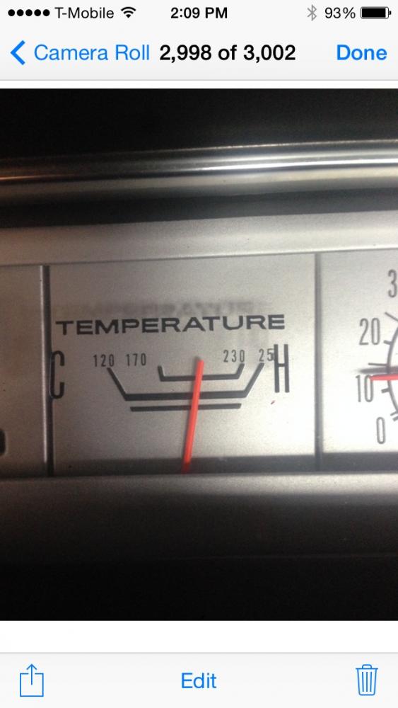

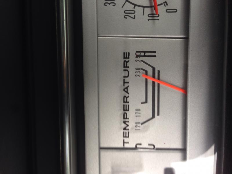

I really feel this is a tuning issue! So even though the engine temp shot to 225 again after a warm up and only driving around the block and back, what is puzzling is that as soon as I put the car in park and let it idle, within literally 20 seconds I can watch the temp gauge drop dramatically without the car moving. So no engine load and low airflow. The shroud may help, but there is something else going on here!
See before photo of 225 after driving and the one after it reading around 195-300 is 20 seconds after parking at idle.
