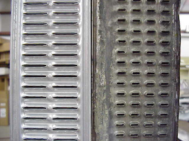

Which radiator would you rather use. Maybe I should start a poll....? I'll pick the one on the left each and every time.
WHY....the correct question is: which radiator has more surface area and which radiator has more fins / Inch (WWW folds) on the air side?? Answer....the one with more surface area....show us the air side fins/inch..
You only give us some of the information needed....how many tubes, their dimensions (length x width x thickness) vs same thing for the other example.
Opinions are useless without comparisons...like apples vs oranges...maybe your example is better BUT without additional information to compare the two radiators the argument is moot.....it's like stating: How high is up?
BOB RENTON
This “debate” over tube size and fin count is the same debate about which dog will win, the big dog or the small dog? The big will ALWAYS win and the radiator with the bigger tubes and more fin count will ALWAYS cool better, ALWAYS! A brass/copper radiator is great, but copper isn’t made to tubes the size of the aluminum, for some reason, I’ve read it’s due to cracking? Plus it would get real heavy.
WRONG.....SURFACE AREA plus velocity thru tubes is the key....either thru more tunes and surface area.....btw....do you understand thermodynamics or just hearsay?
BOB RENTON
The solution to the argument is elegently simple......show us the dimensions, tube count, fin count of your example for comparison. And if you want, include your coolant velocity, coolant temperatures in and out of both coolant and ambient air side temps, as ambient temps effect BTU heat transfer differences......that way everyone will know which radiator design is more efficient....yes? A blanket comment without substantiation is USELESS.....WHY do you disagree??
