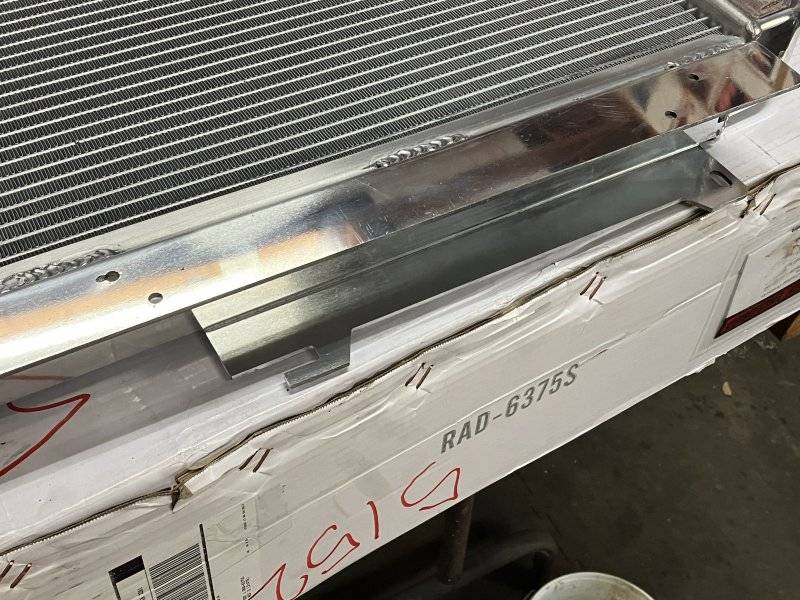

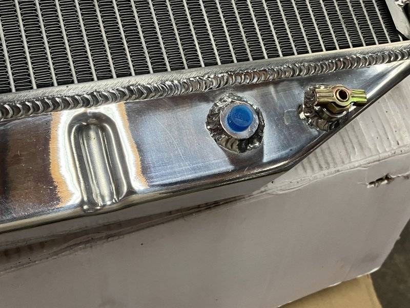

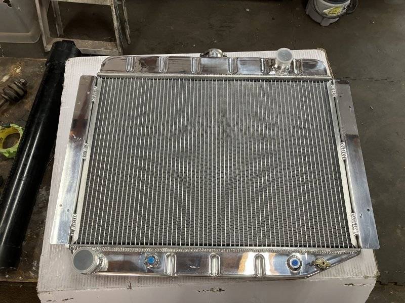

The radiator arrived last week.
Pretty nice looking unit for a beat up car!
Transmission cooler at no extra charge….

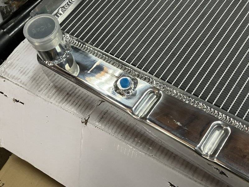

Nice thick mounting flanges:

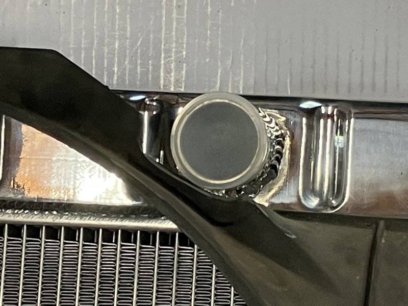

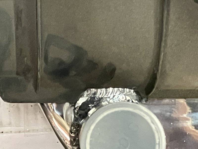

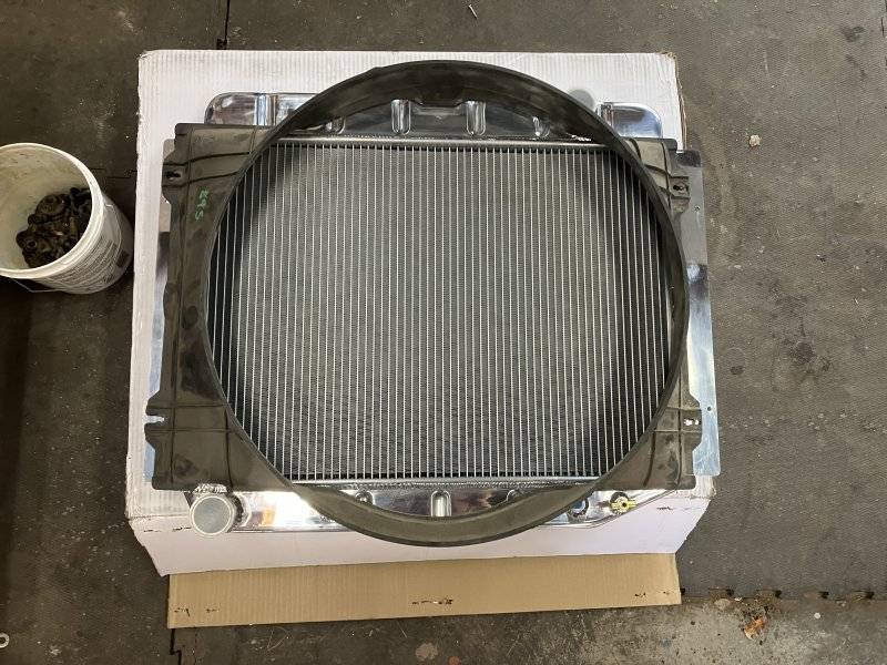

I went through my stash and picked a shroud. I have 2 from the 85-89 Chrysler Fifth Avenue cars. They had 26" radiators but also used bigger fans. The opening in the shrouds that I have are approximately 22", compared to around 20" in the stock shroud I have in the red car. I'll be using a bigger fan and shroud with this radiator. I've used a 19" 5 blade fan but I'm switching to a 20" 7 blade fan from that Fifth Avenue.
Since the shroud isn’t stock, I had to clearance it a bit where the hoses will go.
By the way did you mention the brand, price , width, and # or rows? Was just curious what you selected. Interesting my current radiator has the oppostive configuration with the entry port on the upper right (drivers) and the exit on the bottom left (passenger). I am a little baffled on these configurations. I guess my water pump is backwards.
Sorry if I missed this above, but was your prior radiator corroded inside and / or did you try to clean it first?
Your radiator is configured like a 273-318-340-360 LA series engine. The big block engines of 1970 had the bottom nipple on the left/driver side with the top nipple on the right/passenger side. Somewhere around 1974, they switched to using a water pump housing on the passenger side.

I called ECP and ordered a factory replacement style radiator for a 1970 Charger with a big block. It was right at $300 shipped to my home. I have another one in my red car that I installed in 2018 or 2019. It has been great.

Yeah that makes send. Well the engine block is stamped Oct 1972 so I believe I have a 73 Engine and now a 73 water pump. From the 70 manual, a 440 w/ Air Con took a 26" wide radiator and w/o 22" wide. The 318 took a 19" without Air Con and 26" without. I currently have a 26" and have the ports reversed like Kern said.
There are not a lot of places that sell a 26" rad with the ports reversed like mine with 3 rows but did find it for $300 as well.

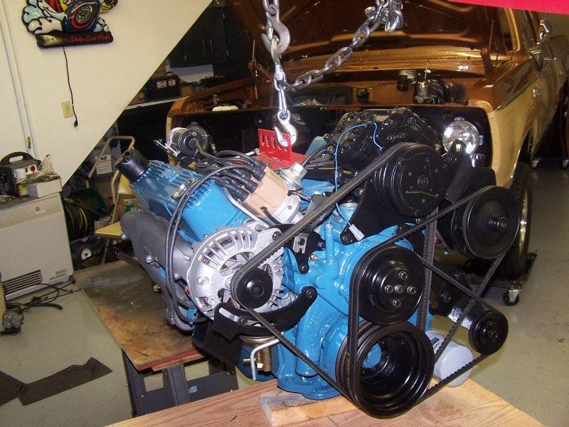

I don't believe that to be true. I have never seen any big block mopar engine with the timing marks on the driver side. Here is a pic of my 78 440 engine. You can clearly see it is on the passenger side. Way too much stuff on the driver side like the PS pump, oil filter and AC.
That looks like my water pump housing setup. What is your alternator belt connected to the upper right of it - that large black component? Is that the air conditioner? I don't have A/C and thing my alternator belt connects to my power steering pulley. Nice engine. Thanks for posting.
