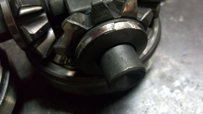

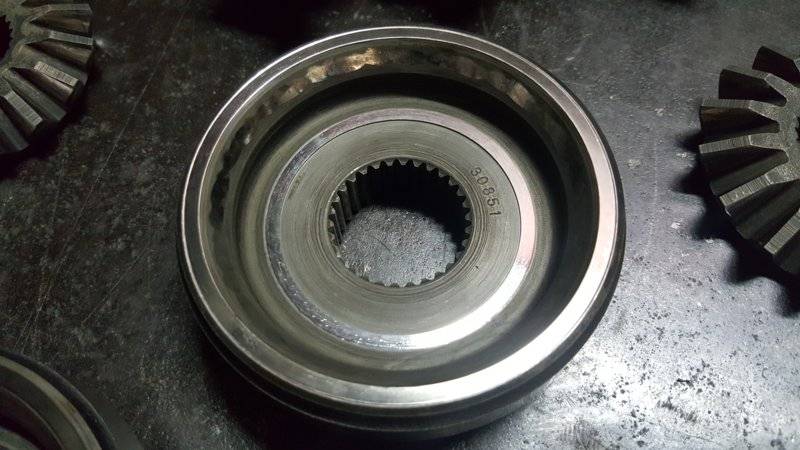

Is this a normal wear pattern or is the flat spot on the one gear causing this?

^ This. If not Cass, then a driveline guy, 4WD guy, someone who works on that all day. I'm no expert, but it looks like an odd failure. I'd want to know why it happened.

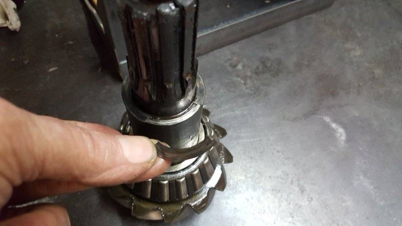

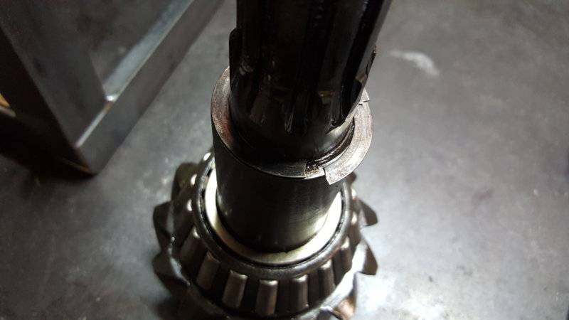

Believe it or not, there were shims behind the front bearing. One was broke and I found the small piece in the nose of the housing. It might have found it's way into the spider gear and chipped it off. There isn't any scar on the broken shim piece though.

I've built a lot of 8 3/4s in the last 50 years and never found a broken shim!

I've broke shims in a Dana. Your pinion has been moving forward and back. Pounded the shim out.

So finding a shim behind the front, small bearing, is normal?
I checked the preload before disassembly (no ring assembly) and it was just under 2 inch pounds. That's enough for pinion walk. Ring and pinion was worn to .012 backlash. Bearings were severely worn also.

the shim is used to set the preload on the pinion bearings in the 742 case --- just get the new internal powerlock kit and be done --- replace your clutches and bearings and if the ring and pinion gear is not damaged you will be good to go.
