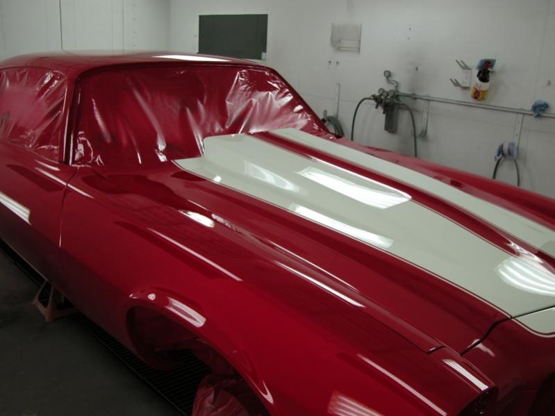

Dupont's premium paint is Standox while their second line is Spies Hecker and thier third line is Nason. Standox is a beautiful product as well. Below is a picture of my buddies Camaro I just sprayed in Glasurit 90 line (waterborne basecoat/urethane topcoat). This product will look this wet for its lifetime if cared for.
Sorry for polluting the thread with a Chebby, just an example.

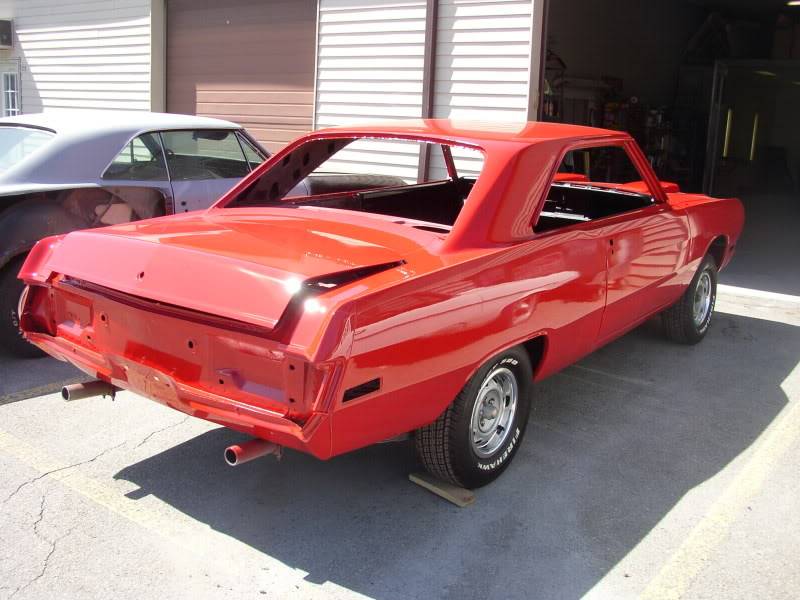

Heres my Dart done with Speis Hecker base and transtar clear. My boss is a big Transtar fan.

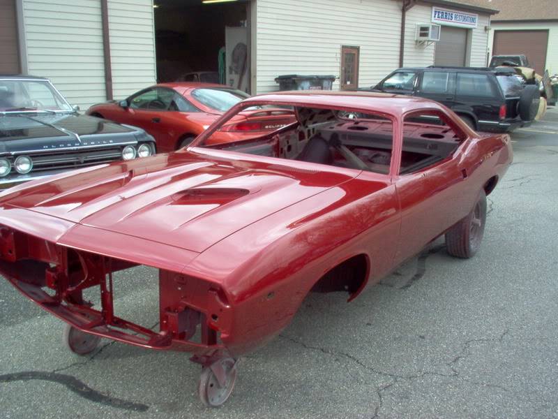

Heres a cuda done with Sikkens Autobse/transtar.

By the way. The shot of the corner of the hood and the fender was one I took to show the match. The hood was painted about 2 years after the rest of the car.
So many choices, what am I gonna do? the cuda with the Sikkens Auto bas and Transstar looks really good. I do believe that is the exact color I'm shooting for, pardon the pun. Adamr, could you tell me the color of the Cuda, that is sharp looking.
The Cuda is an 09 Dodge Challenger color called Inferno Red
