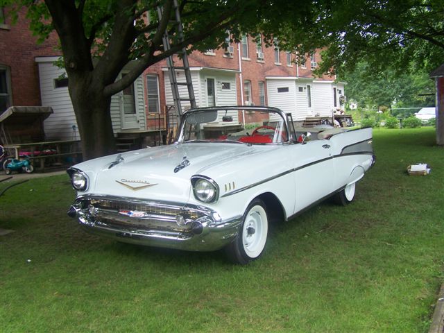

This car was shot in 3 coats PPG Concept DCC single stage then wet sanded with 1000 grit, then again with 3 coats of a 1:1 mix of Concept DCC and Concept 2002 Clear DCU, (both catalyzed and reduced before the 1:1) hand wet sanded starting with 1500, going to 2000 then machine polished using the Presta system. I took the pics under the tree as I detailed it for it's first show. In the full sun, this car needs sunglasses for viewing. Not too bad for the Empirial Ivory.

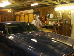

This is PPG Base coat and Transtar clear car was painted where it sits.
Transtar, My boss love that stuff.
