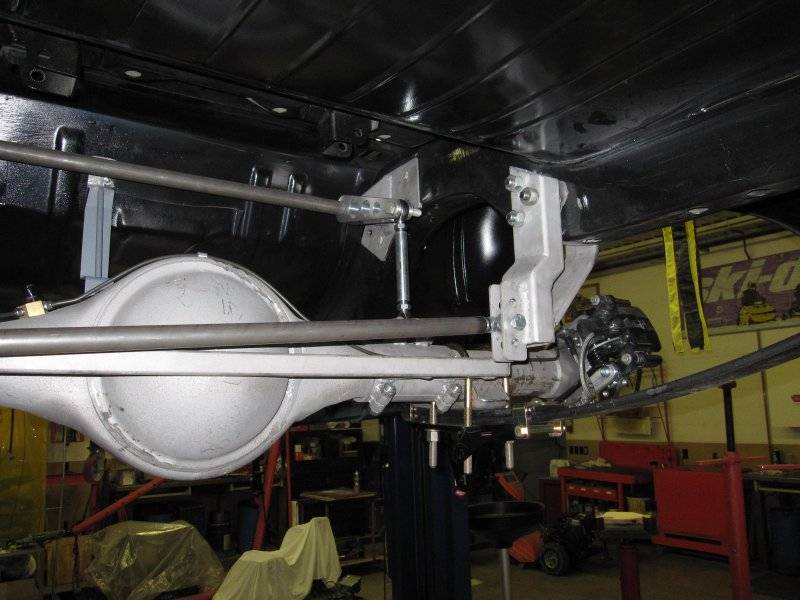

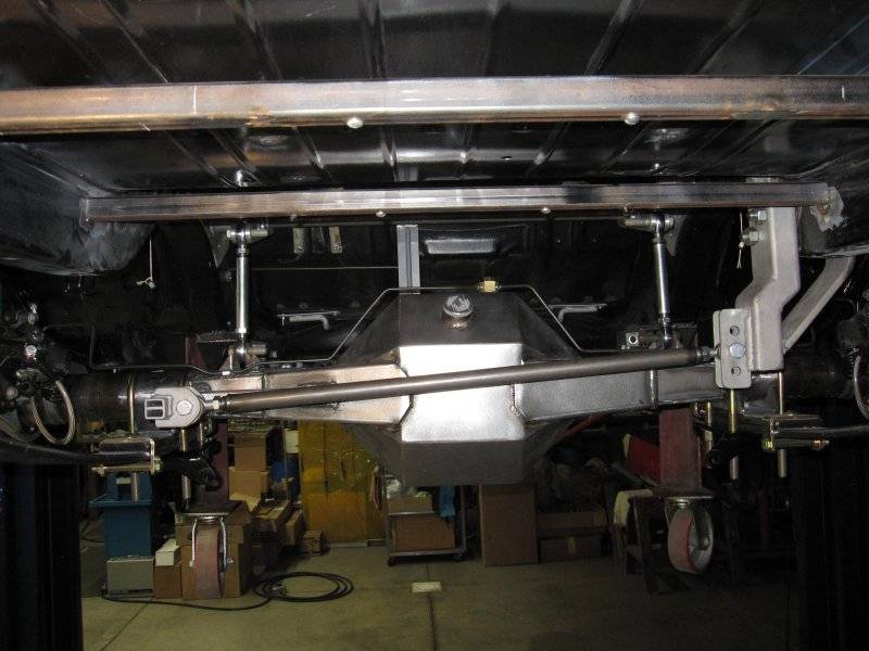

My fabricated panhard mounts (store-bought bar kit) on my 65 Belvedere. As you can see, I switched axle housings during the build. I'm sorry now I didn't go straight to a Strange 60. Note the use of a drag race antisway bar too. I welded in thick-walled tube spacers inside the frame rails to prevent crushing the area.
Mike

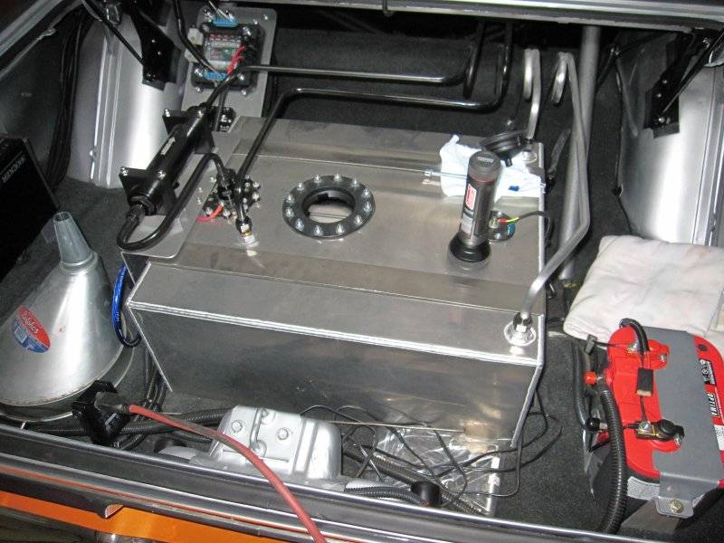

Thanks Mike. I Assume this requires relocation of the fuel tank? Do you have a link to the anti-sway bar?
