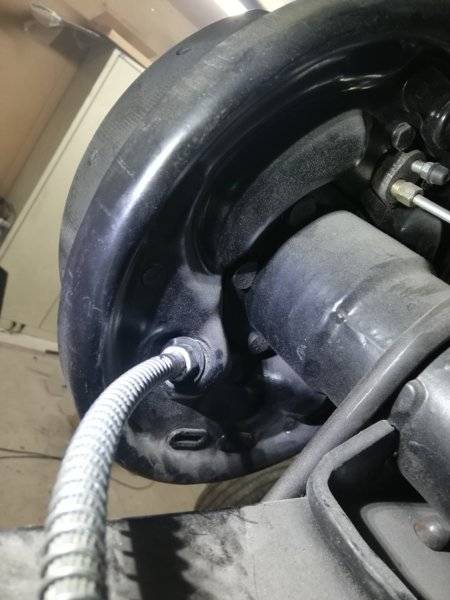

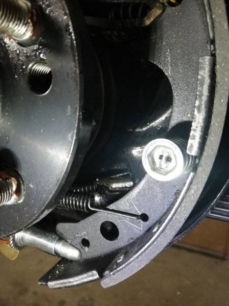

wondering if you could give me some help. I am currently trying to adjust my new parking brake and besides its not yet braking, the pedal is also not returning
Found in an older thread that the return of the pedal is linked with the cable where it attaches the baking plate.
Before i take the brake shoes off, how and where do i adjust the tension to make the pedal return?
BR
C

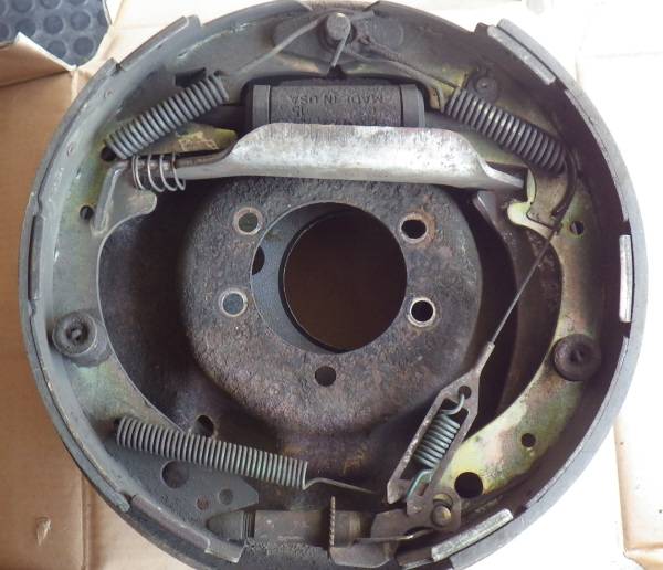

Does your brake set have this silver bar or similar installed?
