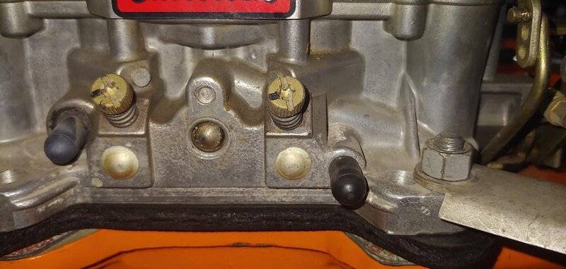

the port on the back is plugged with an pipe plug that will accept an Allen key. However, on the front the tube has been removed and the port is plugged (on both carbs). In the morning, I will get a photo.

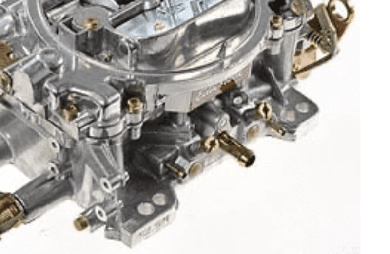

All you is a 3/8" hose fitting with proper pipe thread.

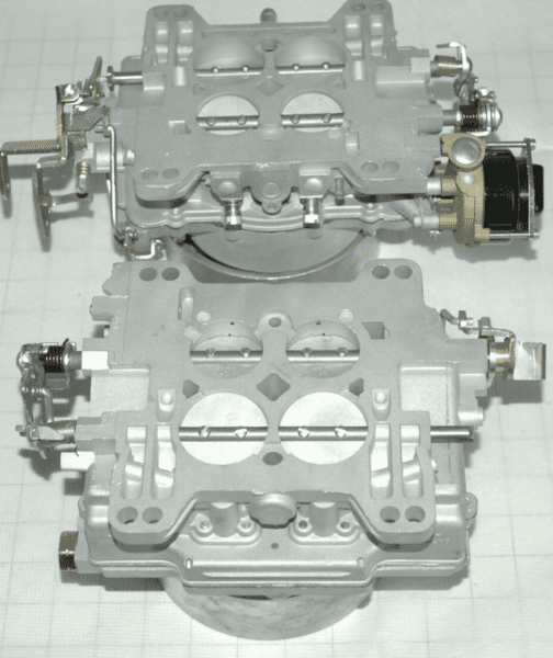

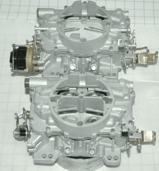

how original carbs were made.
only rear carb had a tube for PCV. front carb was plugged both sides.

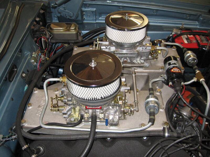

In these photos I "Teed" the pcv to both carbs.Thought being that it balanced both carbs.Worked for me.

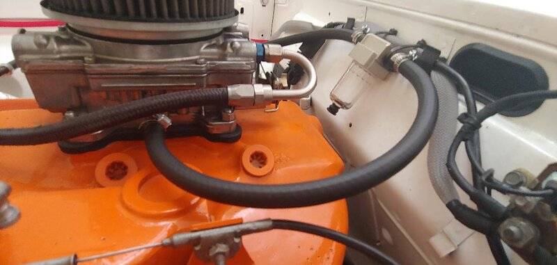

Here is a pic of the plug that is the port the PCV valve should go in. Also a pic of the finished product. I used the port on the backside of the carb instead. Note my homemade oil separator....a water separator for an air compressor works perfect.
